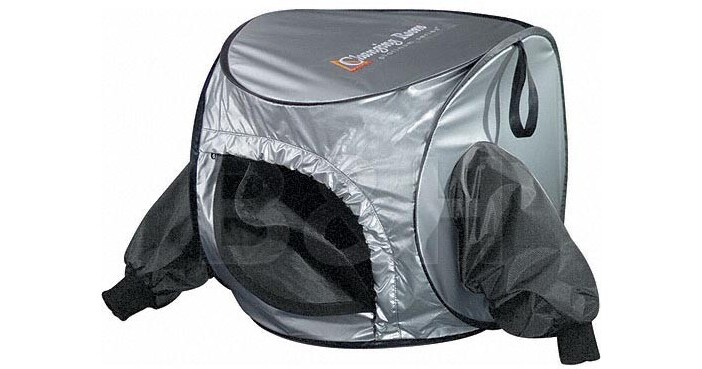

Plastic reels are a PITA to load if damp or your hands are sweating in the changing bag, any brand.
Ensure the lid is snapped down all around the tank as they can sometimes be slightly raised in some places if you're not thorough. I press down ever 30¯ to 45¯.
Even the best occasionally have production defects, contact your supplier or Jobo if you continue to have leaks.
Beats those flat changing bags hands down.
