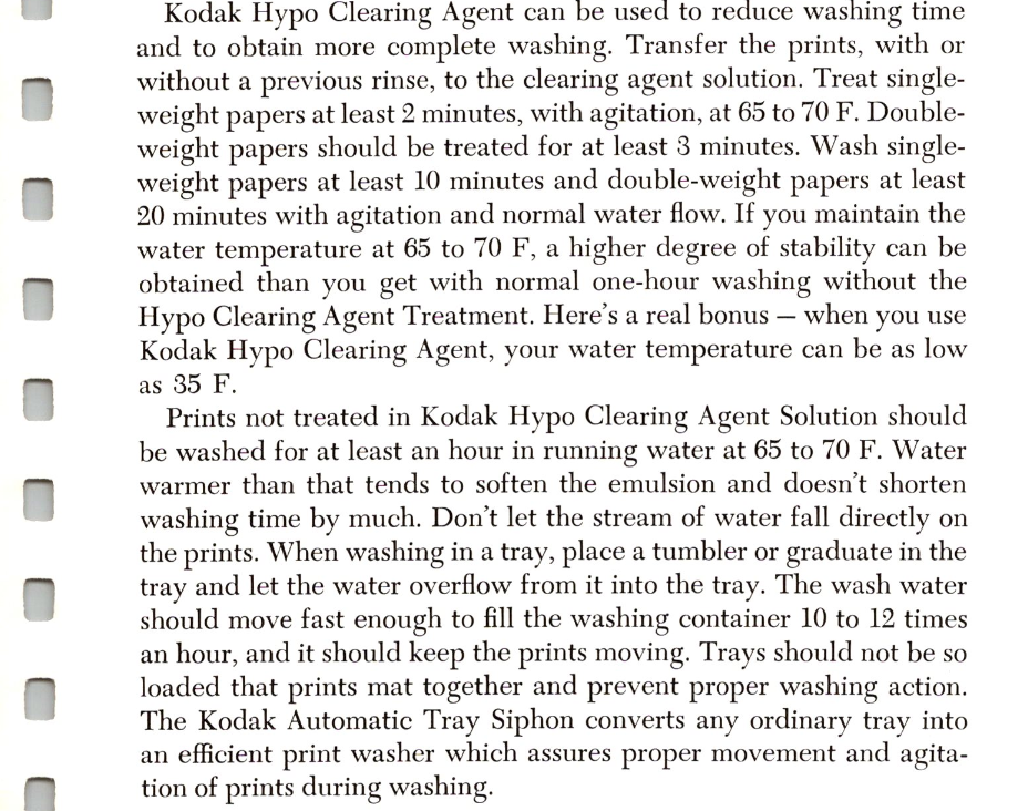

Note that the water can be as low as 35 degrees F.
That is from Kodak Photographic Papers. Also mentioned is that water warmer than 70 degrees does not shorten washing time very much.
I assume they did the tests. So I take them at their word. 35 degrees F is just above freezing.
35F is a c-c-cold wash!

Don_ih
Jan 24, 2021
7,774
Ontario
It sure is.
And, like I said, if Kodak put it in their Data Books, I assume it's true. The claim is that using Hypo Clearing Agent reduces wash times to ~20 minutes for double weight paper however cold your tap water is. Everyone is ignoring that claim, though.
snusmumriken
Jul 22, 2021
2,501
Salisbury, UK
This afternoon I washed some FB prints in our 8 deg C water supply. After Ilford Rapid Fixer (1+4, 2 baths, 1old, 1 fresh, 1 minute in each) each print went into running cold water in a Paterson print washer for 5 minutes, then into a holding bath of cold water until I finished the printing session. Then I washed them all in a Nova Eco print washer for 45 minutes, before toning in Kodak selenium toner. After toning the HT-2 test gave a strong colour, as you would expect because of the thio in the toner. I set the washer going again and went for a walk for an hour. At the end of that, the HT-2 test gave no visible tint. For the sake of seeing what is possible, I didn’t use any wash aid/HCA.
Don_ih
Jan 24, 2021
7,774
Ontario
There was likely still fixer in your paper after the first wash, since you used no clearing agent. A very long wash is required at a cold temperature in that instance - something in the order of 2 hours, maybe? There was very little ammonium thiosulphate in your tray of very very diluted Kodak Selenium Toner. Hardly any would have gone into the paper - more thiosulphate may have been coming out of the paper into that tray. Then the final 1 hour wash got rid of the rest of it. Probably. Maybe.
