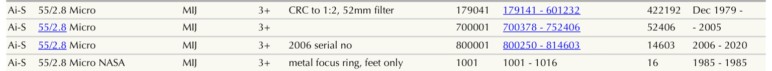

The earliest Nikkor Micro 55mm lenses with low serial numbers cost half the price of the latest ones with highest serial numbers…!
I've never had any issues; but I own a somewhat later example of the 55/2.8; and there are plenty of up those for sale.
The later example is the one to get…!
I was about to purchase one with a very low serial number and canceled the transaction, $187.
Looked for the highest serial number Nikkor and were more than twice the price…!

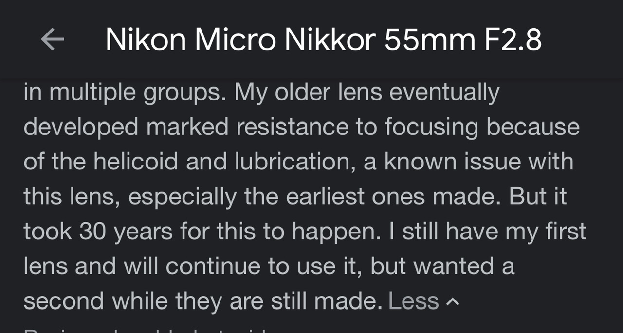

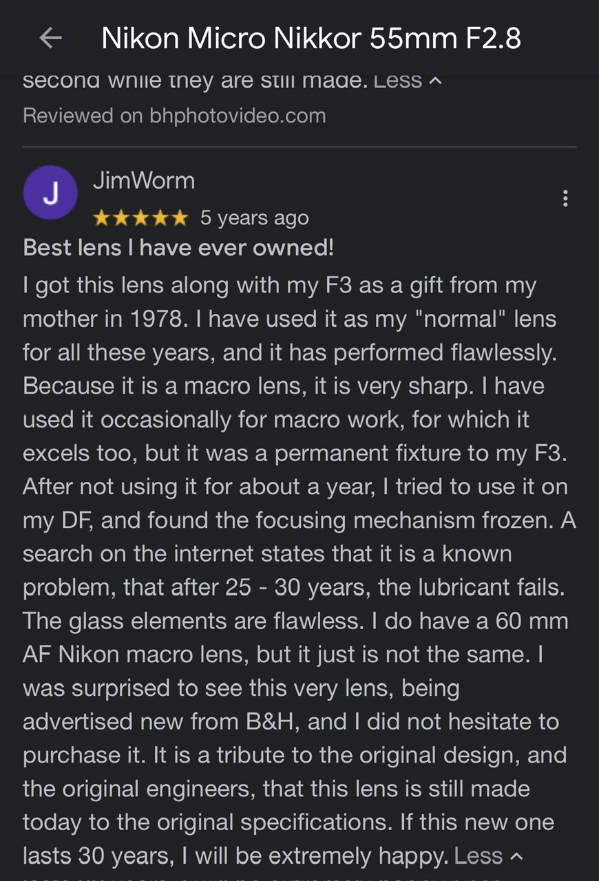

More evidence of the early Nikkor 55mm Micro having oil issues…!
But in my research even the very earliest models take many years for the oil to seep onto the blades…!

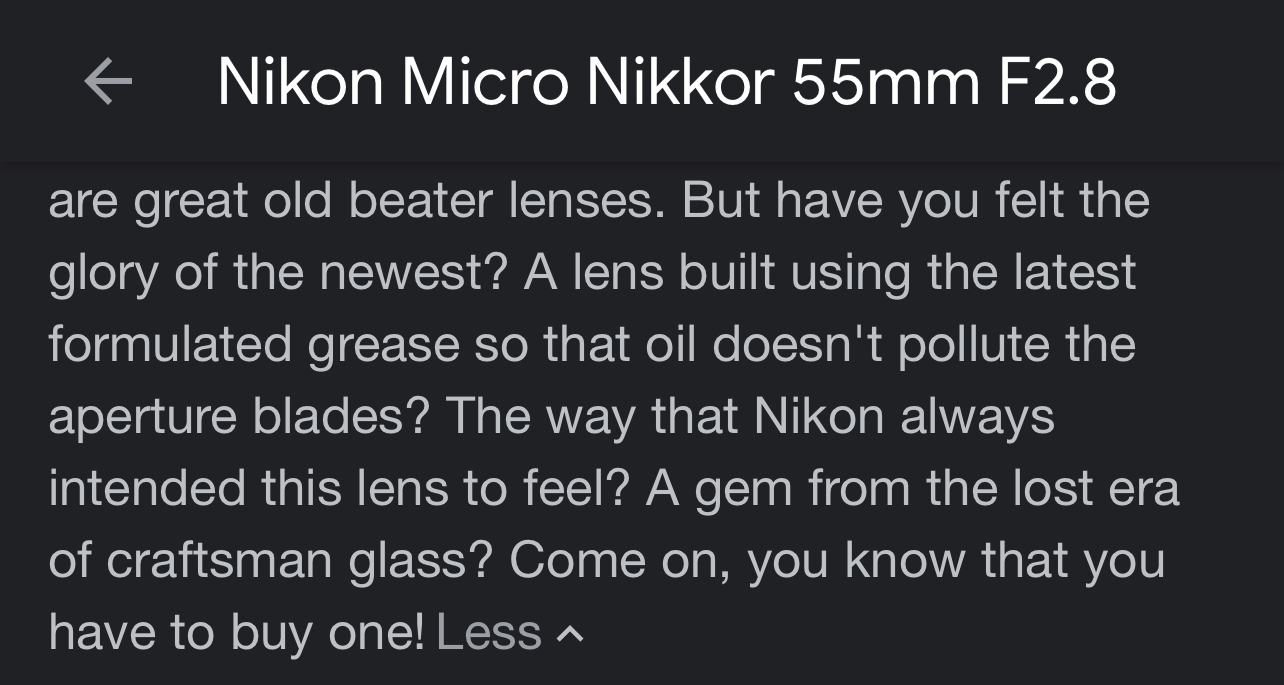

I just purchased the 55 2.8 macro from KEH in excellent + condition. The lens was beautiful except oil on 3 aperture blades. I promptly sent it back. I’ll have to keep an eye out for a newer version.
The newer versions have better oil that doesn’t seep into the blades, “supposedly “…!
