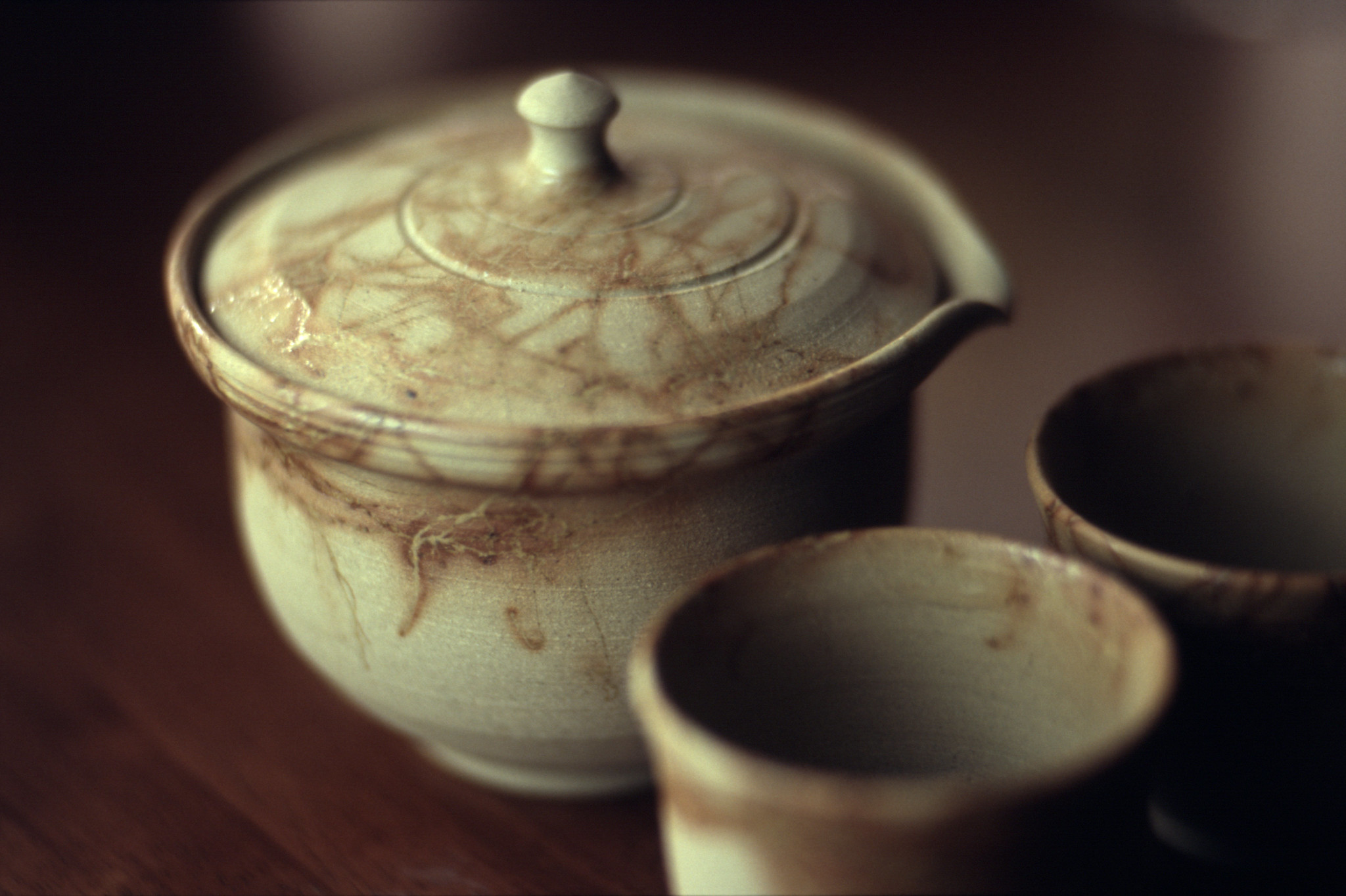

For 35mm closeup photography, I use the Canon EF 100mm f/2 with extension tubes, or the Tamron EF 45mm f/1.8 which can do 1:3 magnification without tubes. Both are very sharp and the Tamron is image stabilized if you need to handhold. For the camera, Canon EOS Elan 7E which has a nice mirror lockup option on a timer.
Here's an example of the 100mm with 12mm extension tube wide open, I like the effect - but gets razor sharp if you stop it down.

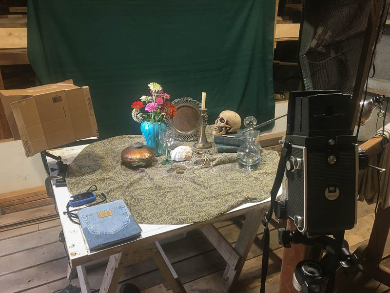

My present tabletop project is a memento mori style still-life. For that, I have been using a 50mm lens on my 135 cameras, and 80mm on a 120 camera (6x6). My "studio" is set up in a barn loft, which is rather smallish, as barn lofts go. With a wider lens, it would become more difficult to keep unwanted items out of the background. And with a longer lens, I might not be able to get far enough away to include the whole scene, but I haven't tested that. It's a moot point for the 120 camera, because I have only the one 80mm lens.
Here is a preliminary photo from the project, which is still very much a work in progress. (I need to take a steam iron to that backdrop!)
The setup. The cardboard box on the left contains my light; but I have since replaced that with a 27" softbox.

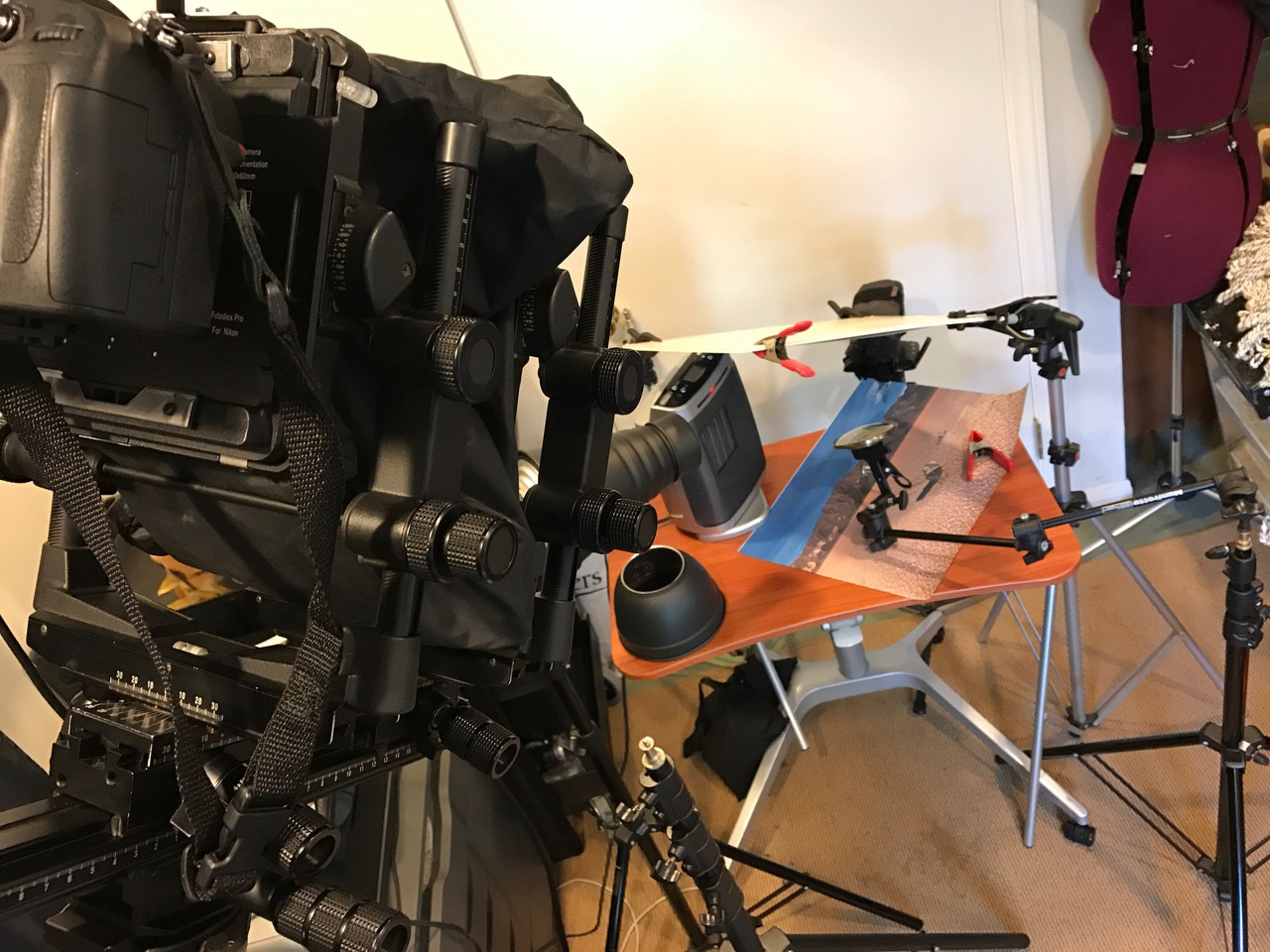

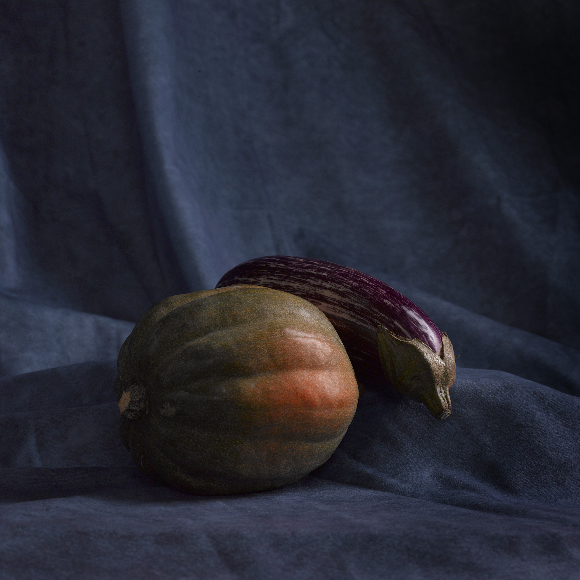

I do a lot of table-top still life work. Although I do shoot about 50/50 digital and film for still life, these are all digital. The equipment is most usually a MF camera with a 90 mm Macro lens, in a very small, cramped space:
Here is one with a FF Digital and 55mm Macro lens:
And one shot with a 4x5 view camera, 135mm lens and a FF digital camera as a back:
and the set-up for that one:

You can get quite close with a view camera and standard lens with a digital FF camera attached. The tilts and swings allow you to get everything in focus, too.

Very nice images.
What camera is that, some model of arca swiss?

The camera is a Cambo Legend with a wide-angle bag bellows and a Fotodiox graflok adapter to mount a Nikon F body. I use a Nikon D4 or D800 with it. Not ideal, a mirrorless body would shorten the distance between the sensor and the lens allowing better distant focusing. As it stands, it cannot focus to infinity. But it is great for table-top work, since the distances are much shorter. Macro work, too. The lens is a 135mm film-grade Schneider, probably 30 or 40 years old. Not up to modern digital standards, but I like the look. The Cambo is a standard studio 4x5 with plenty of movement for swings and tilts, both front and rear. Unlike the newer Alpas and Cambos that are made to be used with digital backs.
