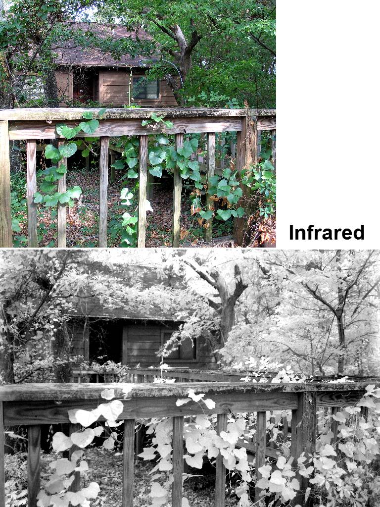

Favorite Camera for IR Film ?
The 4x5 view, 6x9cm rangefinder, 6x7cm rangefinder, 6x6cm TLR, and 35mm rangefinder were my favorite cameras for shooting infrared film.
The 35mm SLR was never a favorite for infrared film because it was too difficult to focus and compose with the filter in place and it was too slow to operate if I had to remove the filter too often to focus and compose.
I used a Hoya R72 infrared filter.
I mounted the camera on a tripod.
I used a handheld light meter to estimate the exposure.
I bracketed the exposure.
I bracketed the focus.
https://flic.kr/p/eDwiuv
