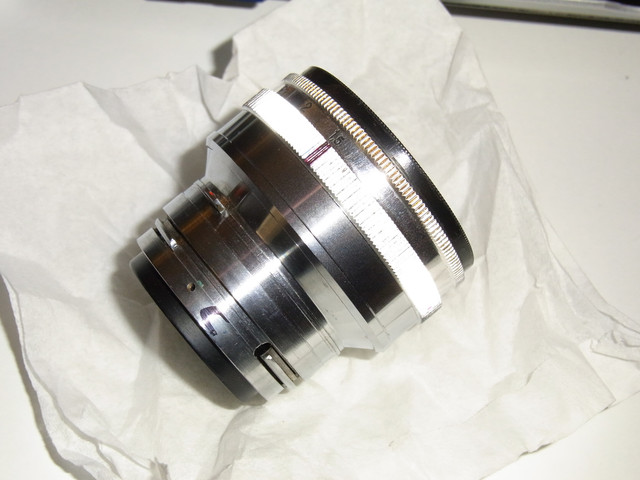

Jupiter-3 5cm F1.5 that I converted to Contax mount. I have a number of these, from left-over parts when converting CZJ Sonnars to Leica mount. The Contax mount has to be polished down to clear the Aperture Ring.
