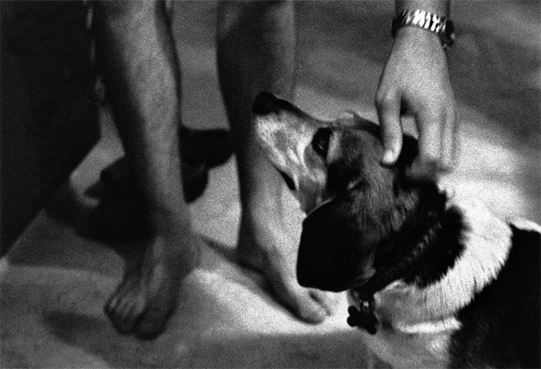

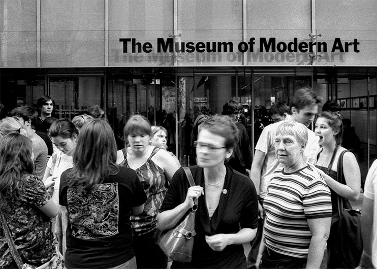

I've used both Delta 3200 and Neopan 1600, and so far I've been impressed with Neopan 1600. The grain is apparent (but not too large) and has a very nice, even structure. The contrast is a little high when used with Diafine, but that's easily corrected with the use of filtration in printing. The tonality isn't exactly smooth, but for 1600 speed, it's pretty good—so is the sharpness, having made an acceptable 16x20 inch print from a 35mm negative.

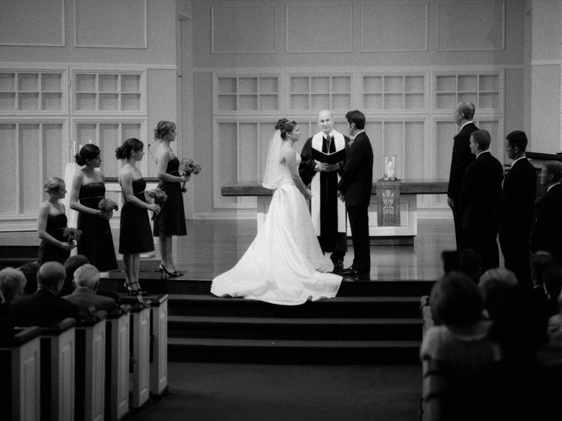

Delta 3200 may be inherently a low contrast film, but you can alter your processing to build quite a bit of contrast with it.
The attached shot is Delta 3200 shot at EI3200 (some loss of shadow detail, but none that's important to me) and processed in HC-110, dil B for a fairly gutsy negative.
This is a proof scan from a 645 negative that fairly OK matches an Ilford MGIV print I made at the time of the wedding. It was eventually printed in lith, but I gave that print to the bride before it could be scanned. Both prints look less grainy than the scan, though.
It's Delta 3200 for me all the way if I need high speed, because it's available in both 120 and 35mm.

Thomas, that's a wonderful photograph. Care to share the processing with us please?

That wedding photo is gorgeous. I have a roll of 120 Delta 3200 in the freezer, but it's so expensive.

Tom, I have my notes at home. I'll see if I recorded the time. I know that it was dilution B and I agitated every minute for ten seconds. You could potentially build even more contrast by agitating every 30 seconds.
I'm not sure giving the time would help, as I did testing prior to using that particular film, with my particular meter, in that particular building, with my particular meter, in my particular camera and shutter, with my particular thermometer and water supply... :smile: You get the picture. Do some testing...
