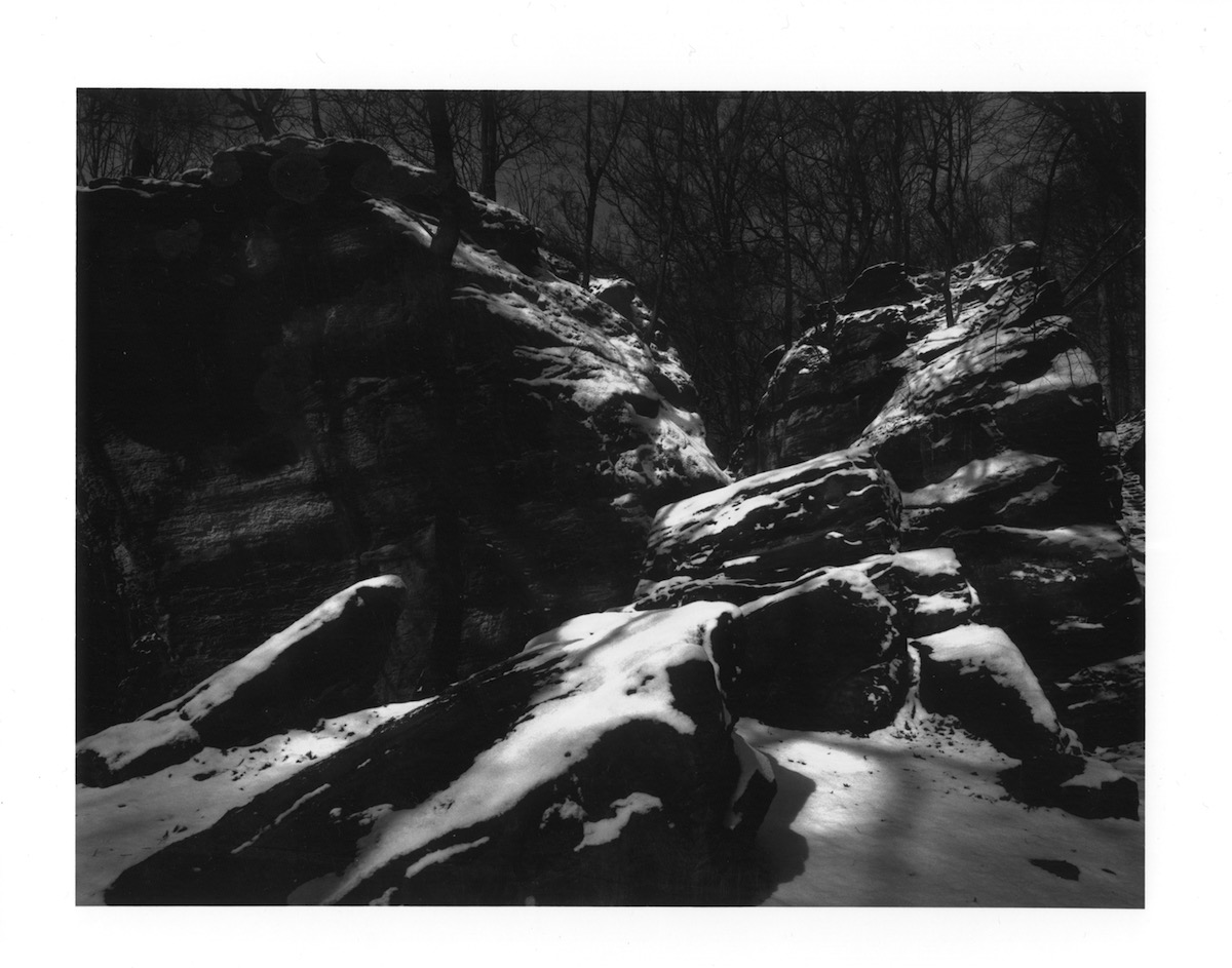

Recent sample. Still experimenting with the best application technique. Currently using a Q-tip for application. May try a brush as I'm getting occasional hard edge border (pretty obvious in rocks top left). Maybe too much bleach on the Q-tip it was making a wet blob.
ic-racer, I may be easily pleased but at this size the hard edged border is not obvious to me. I like it. It asks that question that sometimes IR prints do which is: Is this sunlight or brilliant moonlight. This one has atmosphere for me
pentaxuser

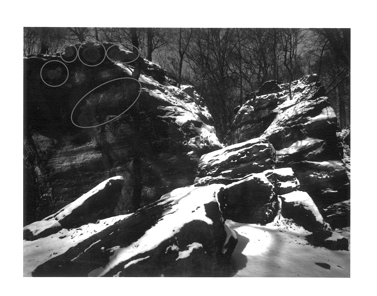

I adjusted the scan of the print so the spots are seen (it no longer looks like the original. The original is dark, like moonlight.). I just dabbed the area with the q-tip and immediately washed it but it left a sharp edge mark. I must have had too much bleach on the q-tip and it acted like a water droplet, maybe I need to blot the q-tip. The other thing I was thinking was photo-flo on the print, so no water droplets can form.
I just came back from the art supply store and got some bamboo brushes to try also.
