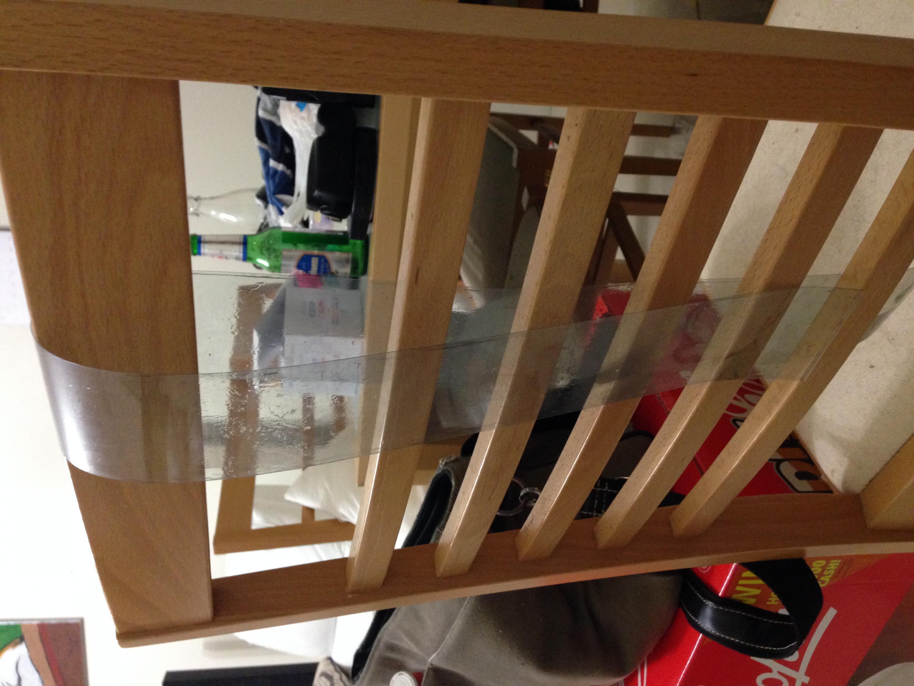

Hi all,
So i tried to process my first roll of Shangai GP3 (iso 100, 120 film) in a paterson system 4 with rodinal.
I had a hard time in the darkroom bag and the film ended up coming off the backing as well as rubbing against itself and sticking a number of times.
I've attached a picture of the film that came out, completely clear and almost all the emulsion seems to have disappeared.
Now most google results indicate I may have used the fixer instead of developer, but I did put the developer in first.
Does anyone have any clues, did I ruin the film in my attempts to put it on the reel?
I'm going to try again but just want to get my head around it.
Thanks all,
Mitch

completely clean could mean you didn't actually expose the film, messing up in the bag would leave creases and scratches, could not 'remove' the emulsion. as long as you had the film in the developer first for a reasonable amount of time, and the film had been exposed to a reasonable degree, something should appear on the film, keep at it, the first film will warm your heart.... until you think about how you could've added some exposure and not had that telephone pole coming out of her head, and used a yellow filter instead of the red, etc etc etc :smile:
so, more exposure probably, it looks as though you've got density on the sides which happens sometimes when handing the closed roll in the light...
Hello and welcome to APUG! It seems that there is a very faint neg (between the third and forth wooden bar of the chair) as well as black marks on the edges. It looks as if it was not exposed properly/or at all. What type of camera did you shoot with? Processing times/dev dilution?

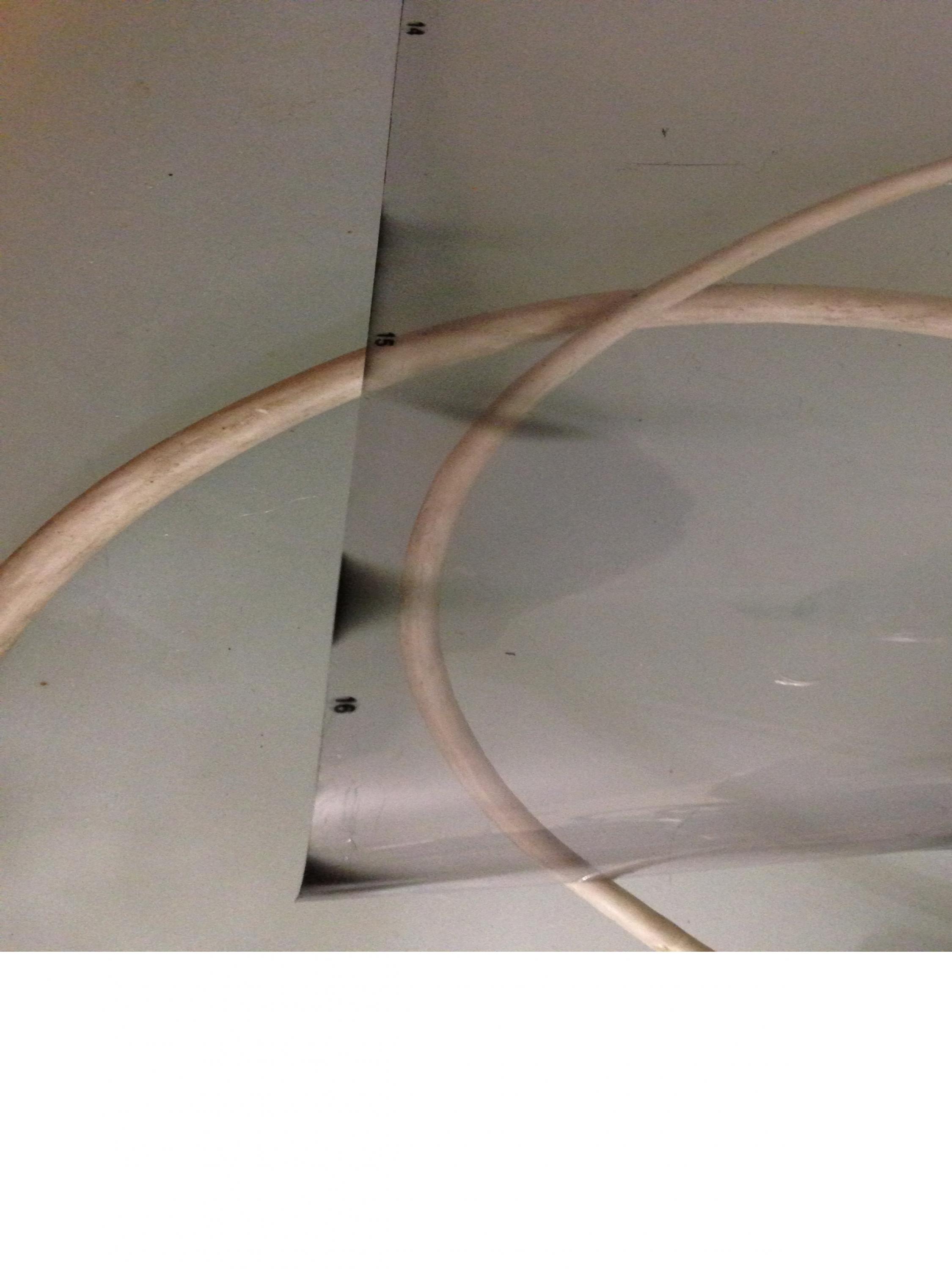

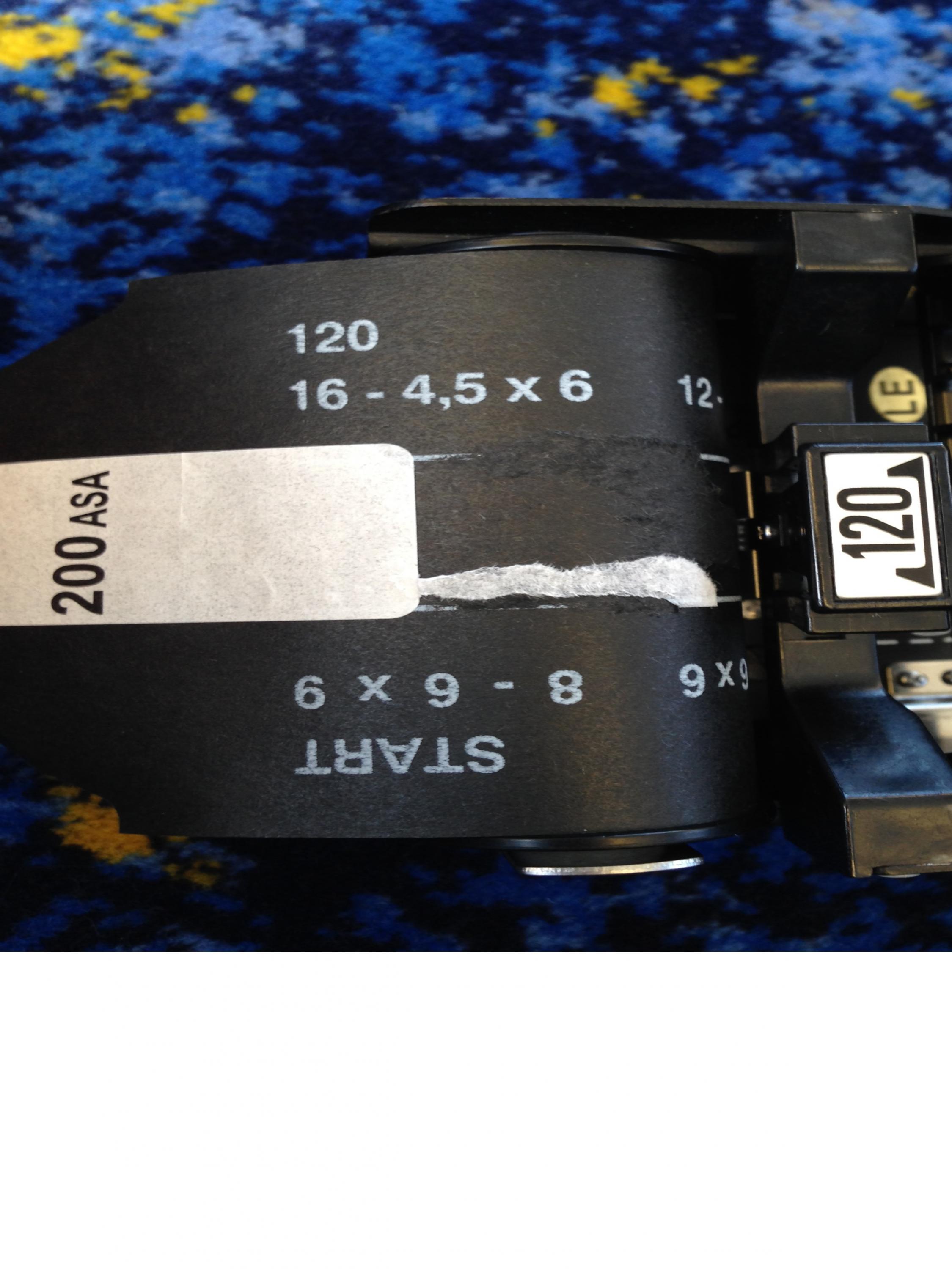

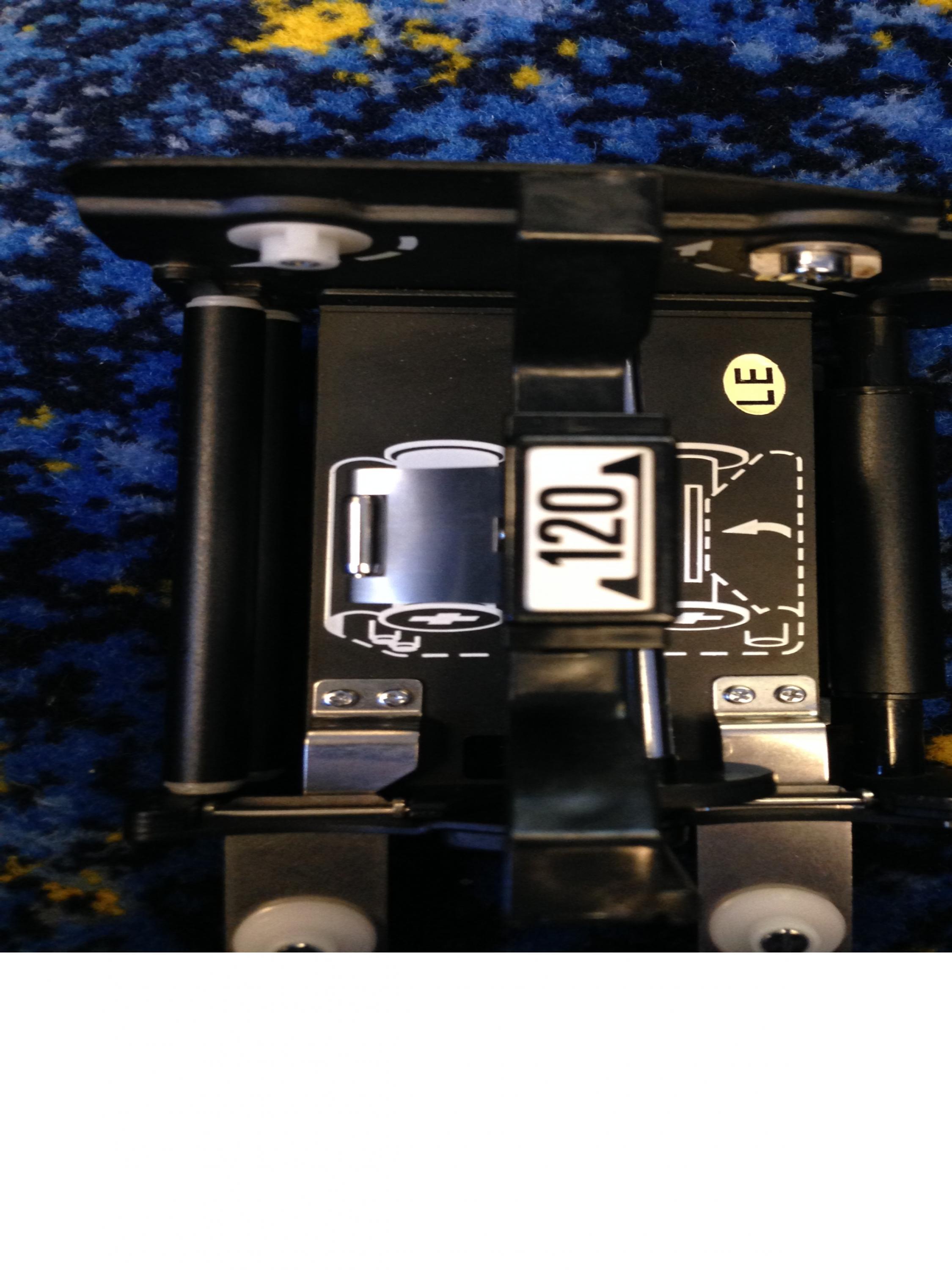

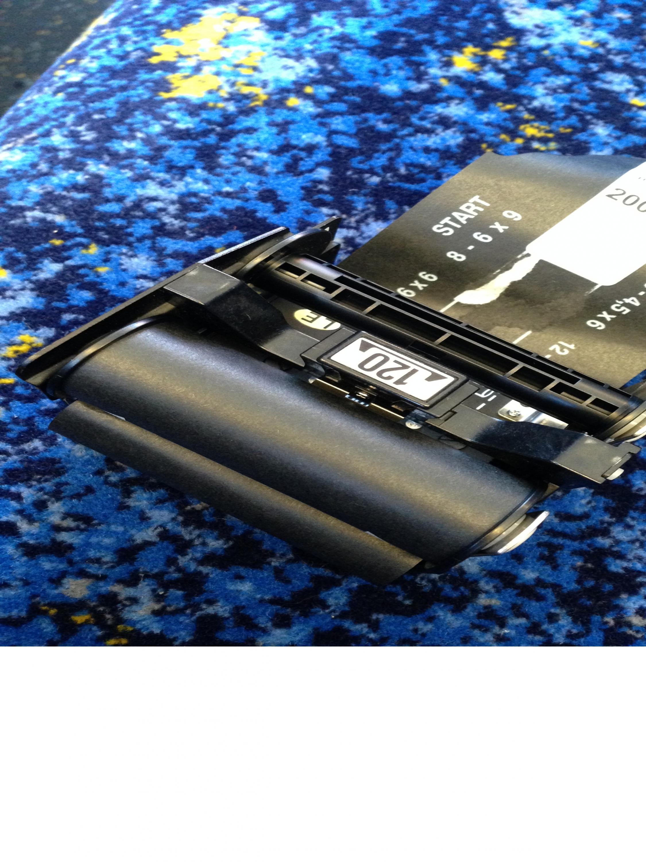

I have attached images:
I developed a roll of Foma 200 this time to check if the film was different or not, there was a very distinct green tinted liquid washing out after the initial pre-develop bath in water!
IMG_2532.jpg: My second develop attempt (Foma 200)
IMG_2535.jpg: The mamiya guide
IMG_2535.jpg: Shows how I've loaded it to start with.
IMG_2536.jpg: Shows how I loaded it after more carefully examining the Mamiya guide.
Much the same results, very clear label markings.

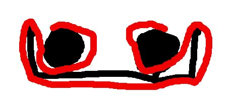

see my diagram
red line is the film. ;-)
