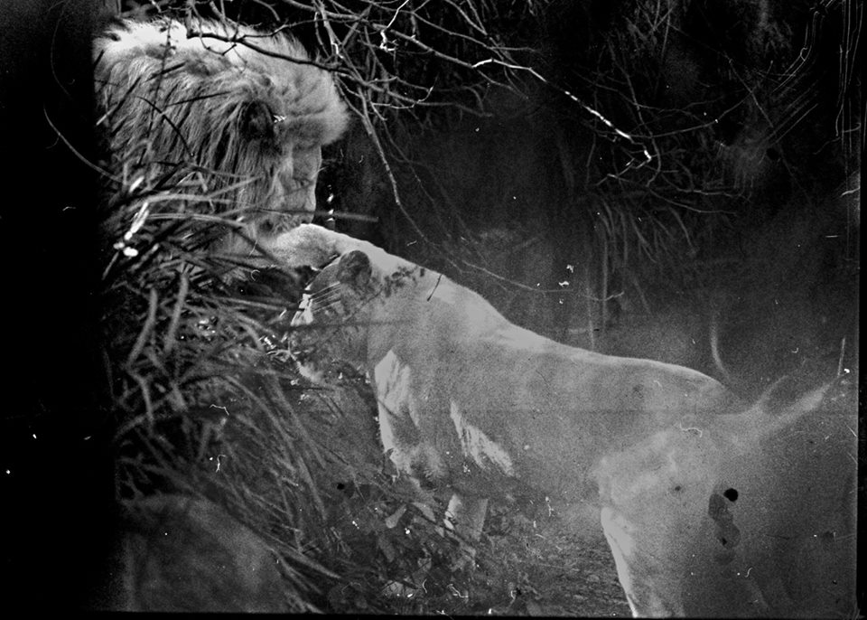

I'm well on my way enjoying film. Here's a picture from a roll of HP5+ that had a bit of light spill onto it but I like the picture and managed to make it somewhat usable. FYI I did discover Rodinal and HP5+ do not play nicely :sad:
