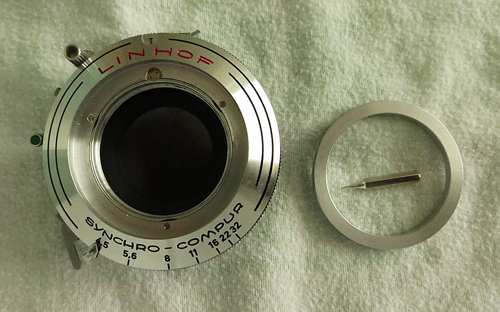

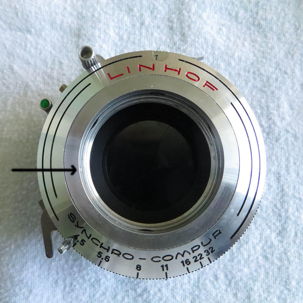

I have been given an old Schneider Kreuznach Xenar (Technica) 150mm f4.5 lens in a Linhof Synchro Compur shutter - see picture.
I don't think it has been used in decades. There is slight internal haze and the shutter speeds are all over the place, sometimes it even fails to close on the 1/2, 1, B and T settings. I assume it is a bit gummed up so I have tried the dodge of exercising it several hundered times but to no avail so, as I don't think it's worth spending money on I, thought I would do a partial dismantle and see if it could be cleaned etc.
I have the tools and I've printed off the manual but nowhere can I find out how to remove the Linhof cover plate. I assume that the ring (arrowed) unscrews but I need to be sure. I think there was a locking screw in a small hole (arrowed) but it is missing. I'm sure I've seen the answer in a forum post but my countless searches have revealed nothing. Can anyone point me to the appropriate thread?

Thanks for your response Agx. The hole is countersunk and I can see threads deep into the hole so I'm sure it's missing.

A locking screw likely can deform a thread flank, thus hampering a unscrewing action.
(If this is the way to release that ring, though what I think it is.)

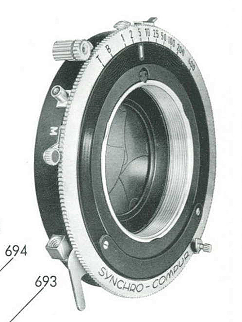

Other Compurs have an eccentric in the ring that is flat on one side and have two small holes. The eccentric is turned until the flat is against the shutter center then the ring turns counterclockwise until the locking ears align with the notches in the shutter barrel. I can see the notches in your picture but I do not see the eccentric, blocked by the arrow?
Check the manual for special shutter or mount.
I checked my printed version and downloaded version, both list CS-1307-609 for the special shutter but there is no illustration or repair instructions.
The inner chrome ring should turn counterclockwise, align with the center barrel notches, and lift off.
Lock screws or pins should go into the shutter case not the speed ring.

Shutterfinger: The features you refer to (image from manual shown below) seem to be under the 'faceplate locking ring?) as I can just make out their edges beneath it (they can also be seen in the first image). From this manual image I still can't fathom out what this darned ring/faceplate screws into - which is why I am loathe to apply brute force until I am sure. :mad:

There's a flat black screw at top center, engaging a recess in the silver threaded front section of the shutter.
That screw head has a flat side. Rotate it 180 degrees so the flat is pointed down.
Then you can unscrew the black ring and remove the front cover.

Leigh, that shutter from post #7 is not the one in question, but the one at post #1.
And yes, there too is that asymmetrical screwhead visible (or rather the respective recess of the female part) at the N-F position of Linhof. But as described above, access to that screw is blocked.

Sucess!! Once I got the dental mirror I could see that the hole had some 'debris' in it and once this was removed I could see the head of a screw deep in the hole. I could also see that the slot in the screw was damaged as were the threads at the top of the hole. Nonetheless I decided to give it a go so, to avoid damage to blades, I opened the aperture to it's max and held the shutter open and got to work with the bit. It only took half a turn and the ring became loose and was obviously not a screw fit. A few more turns and the ring dropped out! As can be seen from the image, everything seems to look as expected so I'm looking forward to seeing what I can do with it.

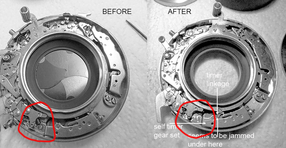

UPDATE - DISASTER

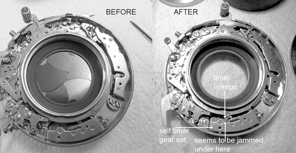

Continuing with my attempts to restore this shutter to a more usable condition I lifted the cam plate off the shutter and then went to make a coffee. When I got beck to my bench I found that my 'friend' had tried cocking the shutter despite my warnings not to touch it! After I had recovered my composure I tried to put things back to where they should be according to my previous photos but it looks as though the self-timer link is solidly jammed inside the gear set housing (see before and after images). The published literature is short on both pictures and information as to how the self-timer and link work so before I get out the hammer and chisel (for use on my 'friend') I thought I would ask you fine folk here in APUG for your considered advice.
shutterfinger
Feb 25, 2013
5,018
San Jose, Ca.
If it were me that friend and I would be having a 3 legged race to the hospital to get my foot out of his ___.
CN-1307-000 Tafel 1 is the best you'll get.
Work around the cocking ring 528 and seat it correctly into place. The self timer actuator catch is spring loaded to the cocking ring and a PIA to deal with.
Look at your pictures, pallet 305 is in its fully retracted position in the left picture, it is fully extended and under the cocking ring on the right one. Press the release at the top of the delay timer which is not numbered, return the pallet to its retracted position, then work 528 back into position. The correct position is shown clearly in figure 1 on Tafel 8.
You may have to remove the cocking ring and reset it.
This shutter cannot be cocked and released with the speed ring removed.

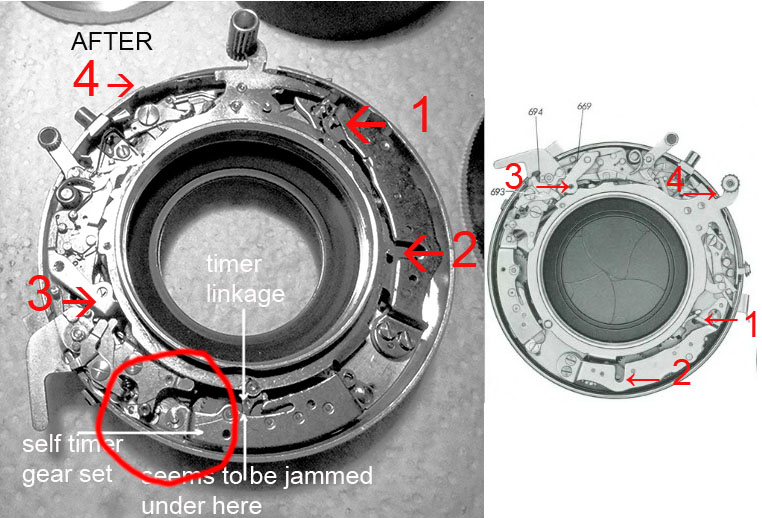

Unfortunately I can't identify '...the release at the top of the delay timer which is not numbered' and the cocking ring is such a close fit around the barrel that I can't remove it whilst the actuator spring catch is stuck in the self-timer so it looks as though I am going to have to remove that to free the locking ring.
EDIT UPDATE.
Whilst sitting gazing at the shutter in frustration I was increasingly convinced there was something else wrong - then I realised that the cocking ring spring has come adrift from it's anchor (see edited picture below)! Now that looks a bit of a complicated problem to me so work is suspended until I can muster up the the nerve to try and fix it!

1.
doohickey that mates into the speed ring. its position, when against the cocking ring is 1 second, against the outer case is 1/100.
2. delay pallet. item 305 CN-1307-000 tafel 2.
3. set latch, item 669 CN-1307-000 tafel 1.
4. cocking lever home/released position.
Left picture you shutter picture modified, right side fig 1 CN-1307-000 tafel 1.
Moving 1 to its travel limit toward the outer case allows pallet 2 to travel freely. If the timing delay were removed from the shutter and 1 was moved to its outer limit 2 would disengage from the delay gearing and release the coil torsion spring AKA mainspring (like a clock) tension. All speeds from 1 second to 1/125 are controlled by this spring and its tension. They are a PITA to reset as 1 gear tooth on the gear the coil torsion spring is attached to makes the difference between some speeds good and all speeds good.
The cocking ring on your shutter is currently in the cocked position. Press 1 toward the outside of the case and hold, move 2 toward the outside of the case, press down on the cocking ring and release 1 and 2 when the edge of the ring is in the path of 1 and 2. Keeping downward on the cocking ring press the shutter release and push the setting lever toward the home position 4.
The shutter only gets more complicated after this especially the release and flash sync section.

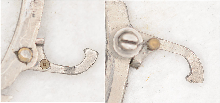

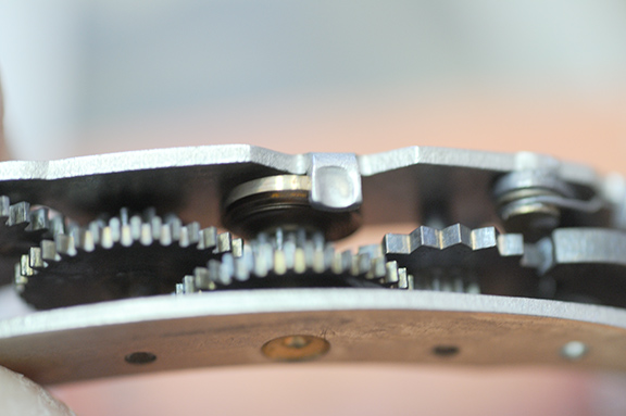

I've made a device to hook the end of the cocking ring spring that has come adrift so I can reinstall that when it's time but I'm still no nearer being able to un-jam the timer linkage as this also stops the cocking ring removal - it looks like time for more drastic action.
