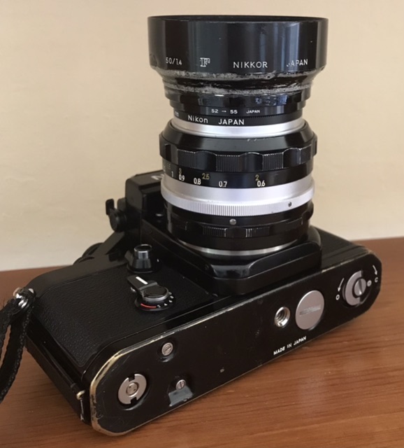

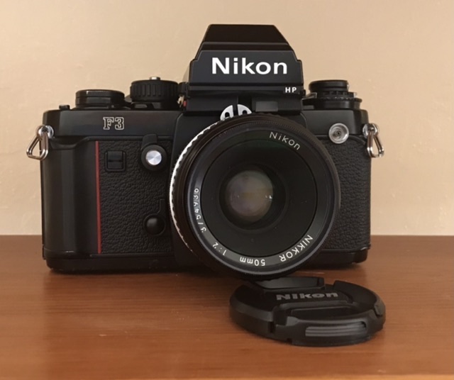

This just arrived, thanks in no small part to this thread. I think I could grow to like the F3.
Thanks. :smile:
Q: F2 or F3 ?
A: Yes, please.
The proper lens hood seems to be absent.
Proper? It is neither proper nor suitable, sir. It is not acceptable, nor adequate. It is, in obvious fact, an abomination.
--Capt. Jack Sparrow
