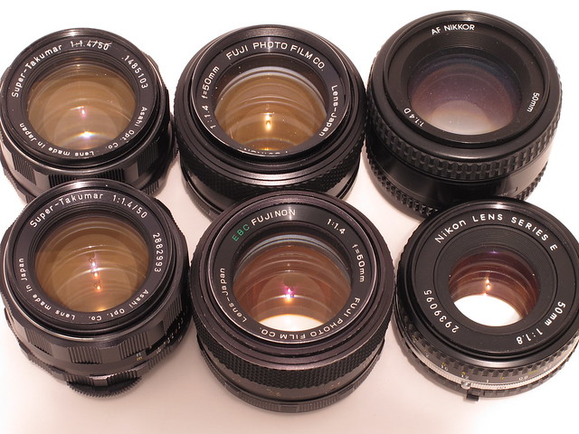

I have two non-SMC lenses; one is 8-element (upper left) and one is 7-element (lower left). I think the 8-element is the better performer of the two. In fact, of the six 50mm lenses I use, it is my favorite and is well deserving of the premium price.
50mm Lenses by Narsuitus, on Flickr
