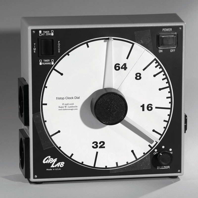

I currently use an RH Designs ZoneMasterII and TimerII combination with my Durst L1200. They are a joy to use and let you fully concentrate on printing, without having to deal with f/stop calculations for the base exposure or any doge&burn exposures. Prior to that, I used a GraLab 300 with a self-made clock face for a while, but that was just a compromise. I don't want to do any darkroom work without an f/stop timing ever again!
