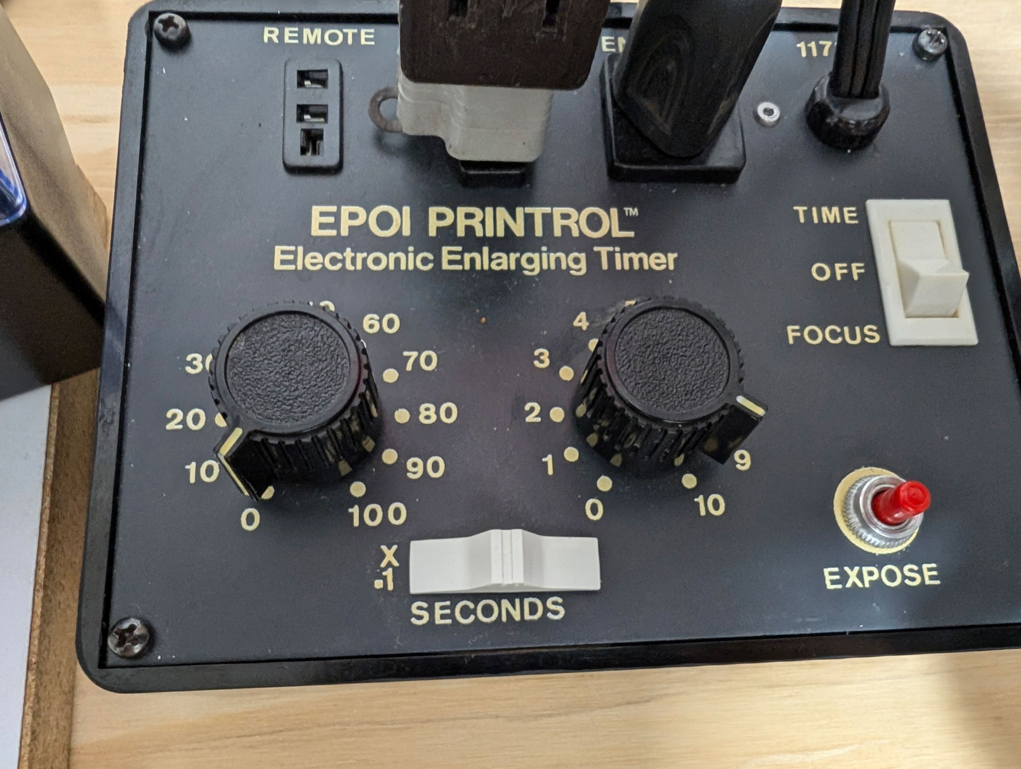

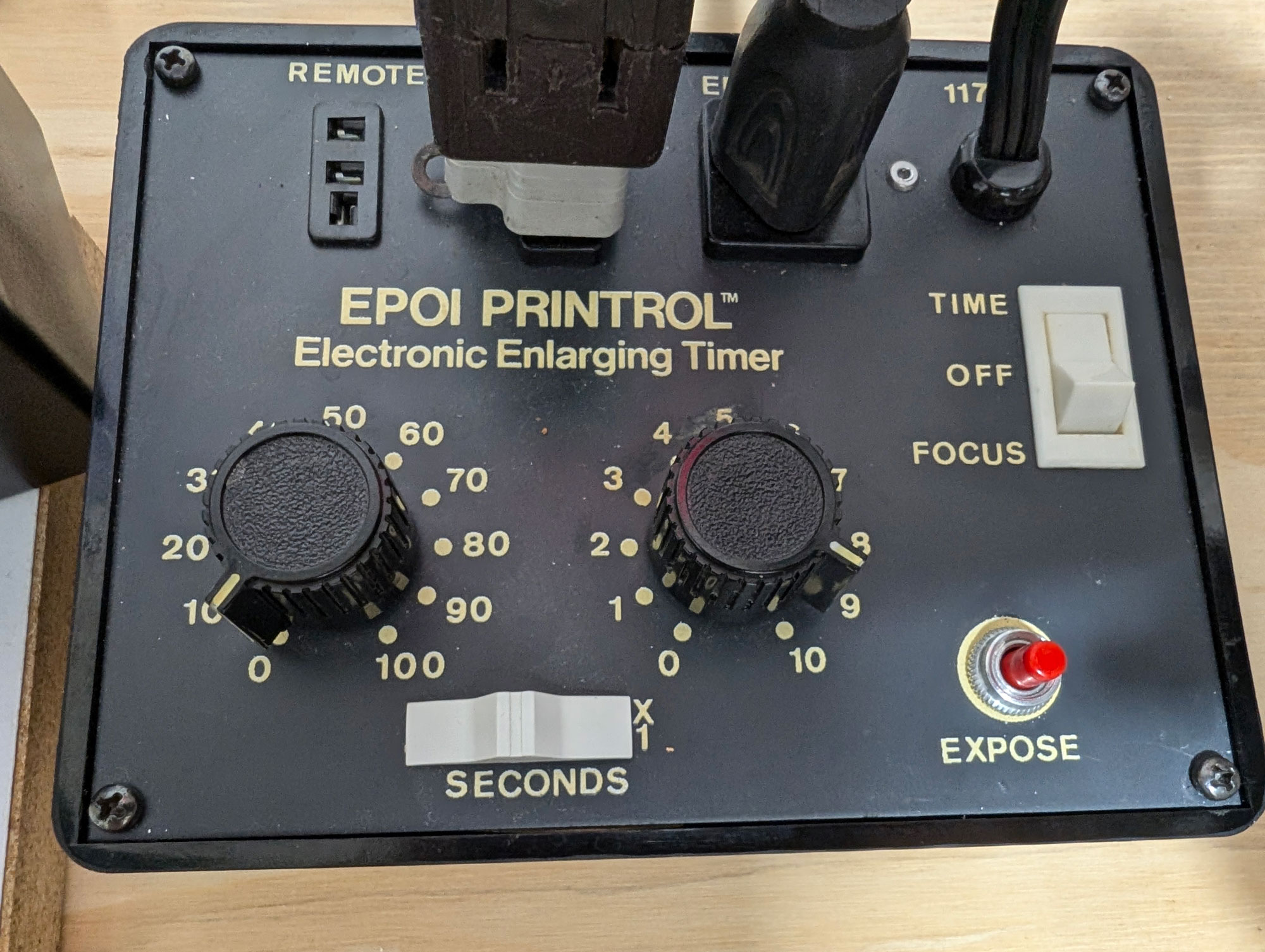

I recently decided to try f-stop printing and I'm trying to figure out if my EPOI enlarger timer would work well with that workflow. The switch on the bottom says "SECONDS" and toggles between "X1" and "X-1". I'm assuming that this refers to seconds and tenths of seconds. Based on that assumption, the knob on the right does seem to do tenths of a second when in "X-1" mode. However, the left knob gives very inconsistent results.
In X-1 mode, 10 on the left knob gives about 1 second. 10 = 10/10 = 1, seems simple. However at longer times, this breaks down. Set to 90, I got over 2 minutes of light. Does anyone have any insight into how this timer works? Bonus points if you have any info on EPOI, I can't find anything about the company online.

It's actually "x .1", a decimal point not a dash, so your assumption that it should multiply the time on the dials by 0.1 is correct. I don't know why it's not giving you the right time. Do both dials give you the time in seconds in "x 1" mode?
Maybe one of the dials is dirty. I have one of these timers, although I don't have access to it at the moment. IIRC, to inspect the components / wiring, you just need to loosen the screws at the corners and lift the faceplate out of the box. (Unplug it first, obviously.) My instinct would be to shoot some electronic contact cleaner into the dials and switch and work them back and forth a few times.

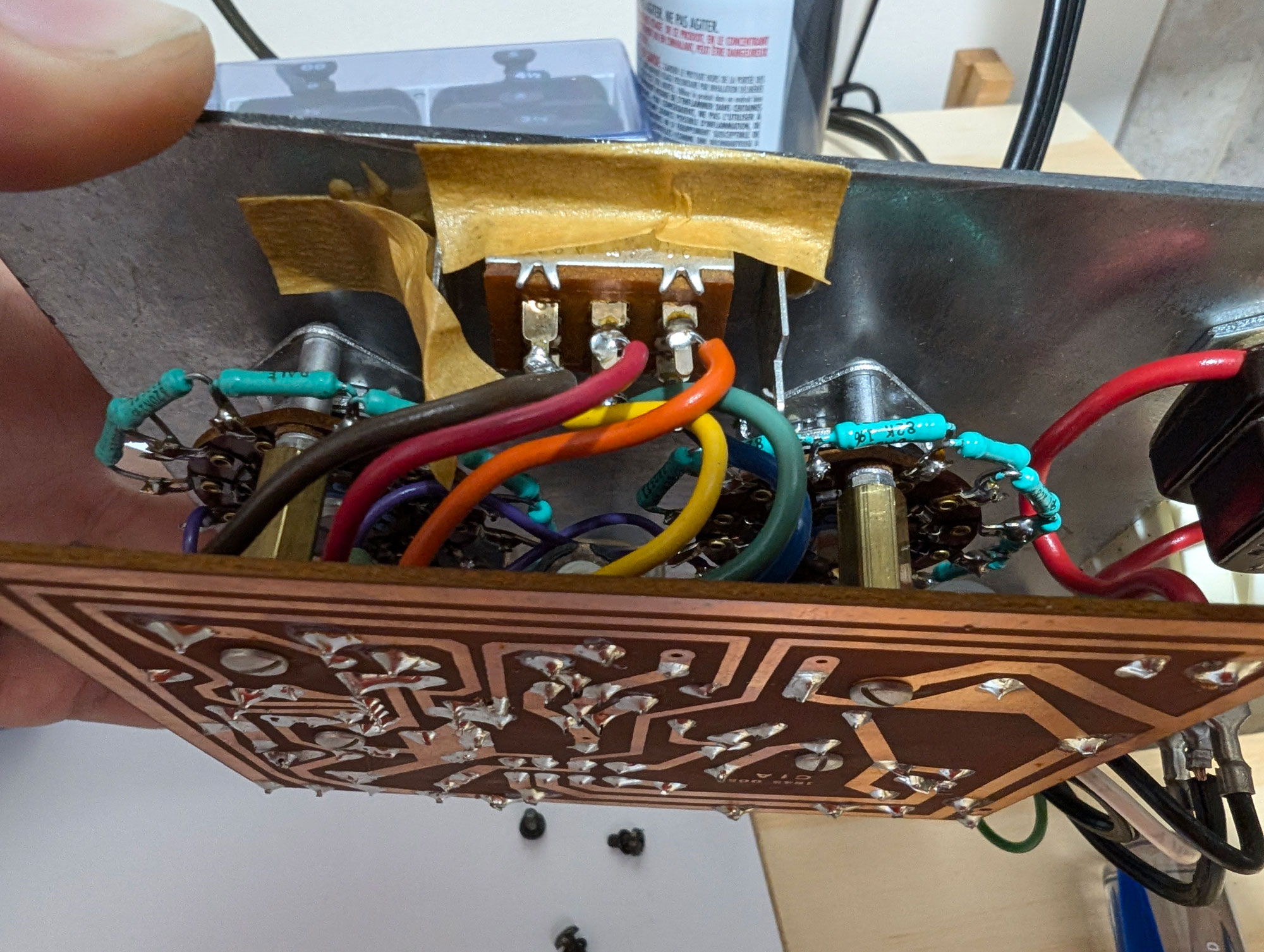

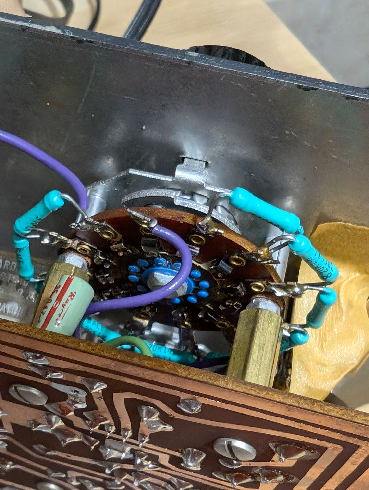

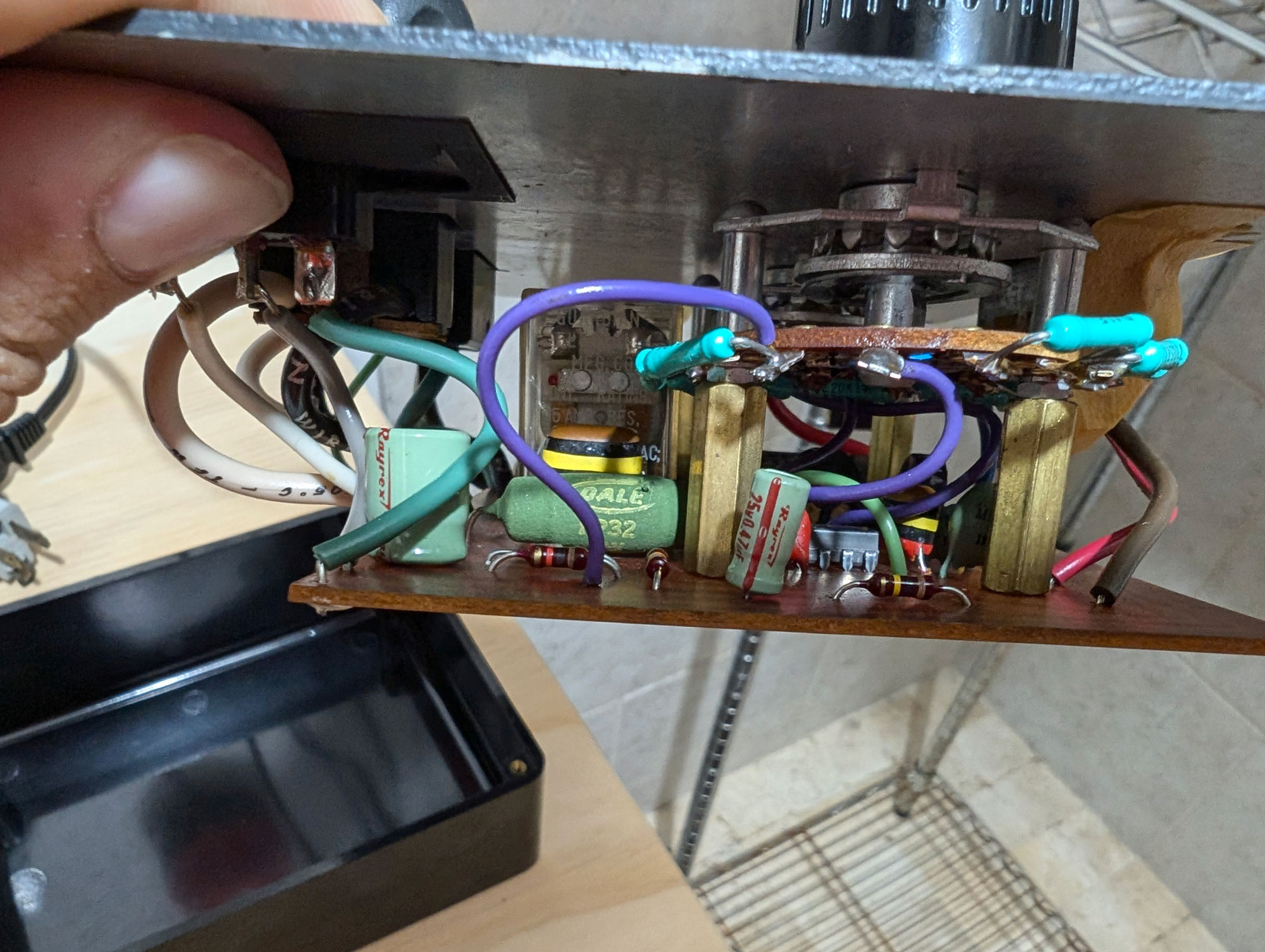

I opened up the box and admired the colorful array of capacitors and resistors (pics below). No immediate signs of leaking/bulging/corrosion. I sprayed a bunch of contact cleaner and wiggled the knobs a ton. Each knob position has its own individual resistor.
I reassembled and did some more testing. The right knob feels dead-on timing wise, but the left knob is still off and the timing drift gets progressively more noticeable with each subsequent click of the dial. (At the 90 and 100 positions, I'm not sure the enlarger light ever actually turns off. I waited several minutes before losing patience and resetting the timer.) It also drifts in full seconds mode, but the drift is far less noticeable. 100 seconds yielded 104. Not ideal, but pretty impressive considering the age.
From my testing and the info in this thread, I'm pretty sure there's a specific timing capacitor for the left knob in X.1 mode that has gone sluggish, particularly at longer exposure times. I think I'll hold onto the timer and take it to a friend with more electrical engineering and soldering experience. Could be a fun project to located a replace the culprit.
In the meantime, I'll start looking into upgrading to a modern, electronic timer. I know f-stop printing can be done with just about any timer, but I want the precision of accurate fractions of a second. The timers from @Nicholas Lindan and RH Designs both look promising.

Looks like it uses 1% Dale resistors in the timing switches - which are high quality components. Good chance the IC is a 555 timer. The black and orange wires from the x.1 and x1 switch should each go to a capacitor. As you surmise, it is the capacitor connected to the x1 position that is likely the culprit.
