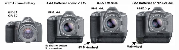

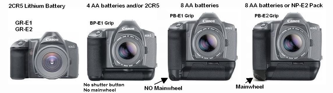

Most people say the eye control AF is more of a gimmick. The EOS-1 is only slightly larger and heavier with the standard grip. (150g heavier)
Both cameras can use any of the optional grips for more battery life, or frame speed.

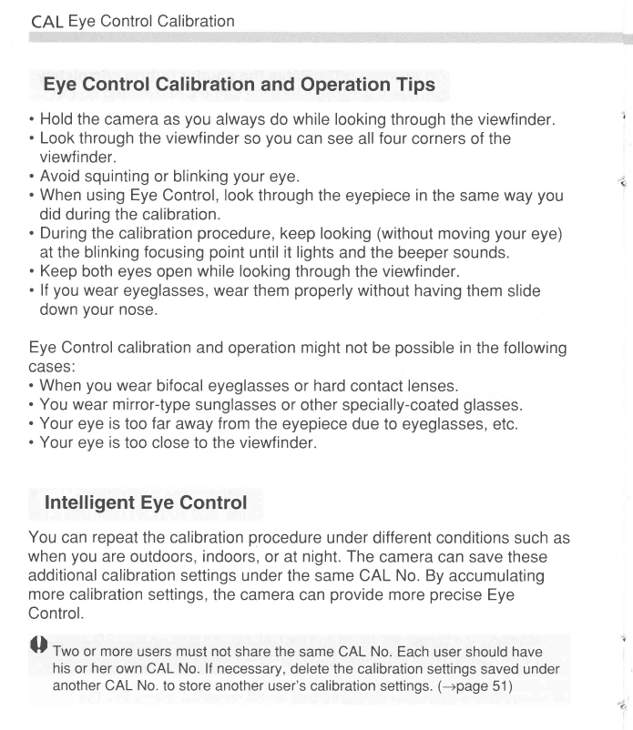

Here are the additional "tips" from the manual:

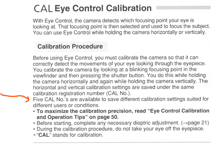

A suggestion - consider programming and then switching between two different calibration settings - one for portrait and the other for landscape.
You probably recall that you have 5 different settings available to you.
But as I posted earlier, the system does work well for some, and poorly for others, and it is difficult to tell ahead of time which group any one individual will fall into.
