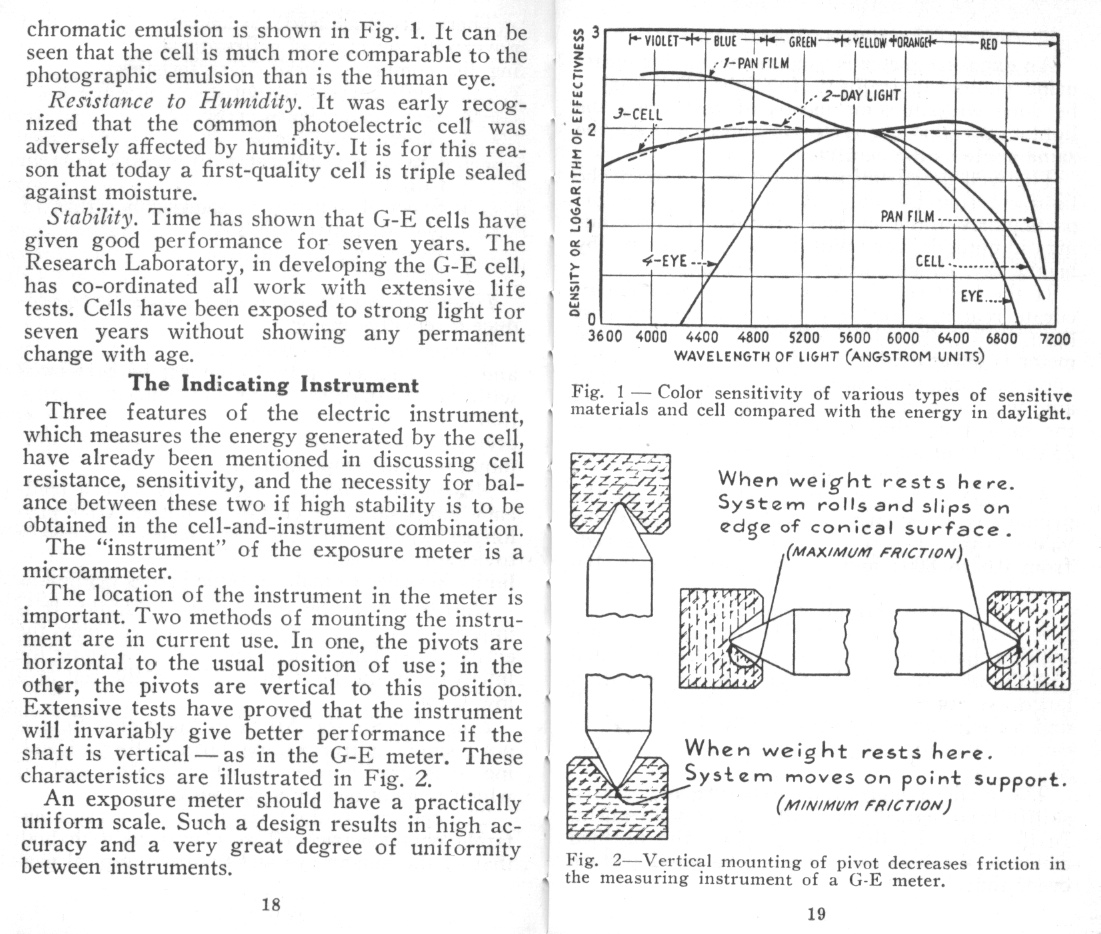

When you figure "how hard" it seems to be to use a light meter, I keep asking myself the same question...
It is fun reading about the invention... GE's booklet has a diagram as prominent as the spectral response chart... which touts their point-bearing horizontally-oriented needle's superiority to the obviously Weston Master inferior conical-bearing vertically-oriented needle which suffers from much greater friction...

. . . GE's booklet has a diagram as prominent as the spectral response chart... which touts their point-bearing horizontally-oriented needle's superiority to the obviously Weston Master inferior conical-bearing vertically-oriented needle which suffers from much greater friction...
The main advantage of GE's vertical meter movement axis is the minimum effect of an unbalanced meter movement. Tremors in the hands of us oldsters is usually enough to eliminate the effect of friction. You youngsters can also tap the meter to do this. I've used Weston meters with a somewhat unbalanced movement, but it is a nuisance. Unlike zeroing the meter, correcting an unbalanced movement in either meter is tricky.

... the obviously Weston Master inferior conical-bearing vertically-oriented needle which suffers from much greater friction...
Interesting point you make but I'm not too sure about superiority-inferiority. I've used a Weston meter for about 30 years and only recently saw a manual. Ends up that I've been using it incorrectly all these years, yet still get great meter readings and reliability. :laugh:
Another load of rubbish from Generous Electric. Both meter types are equally subject to friction, and both work just fine.
Bill Burk
Feb 9, 2010
9,500
It may be rubbish regarding the point friction claim. But... for something that works just fine 10 times longer than tested... that over-engineering's gotta mean something.
