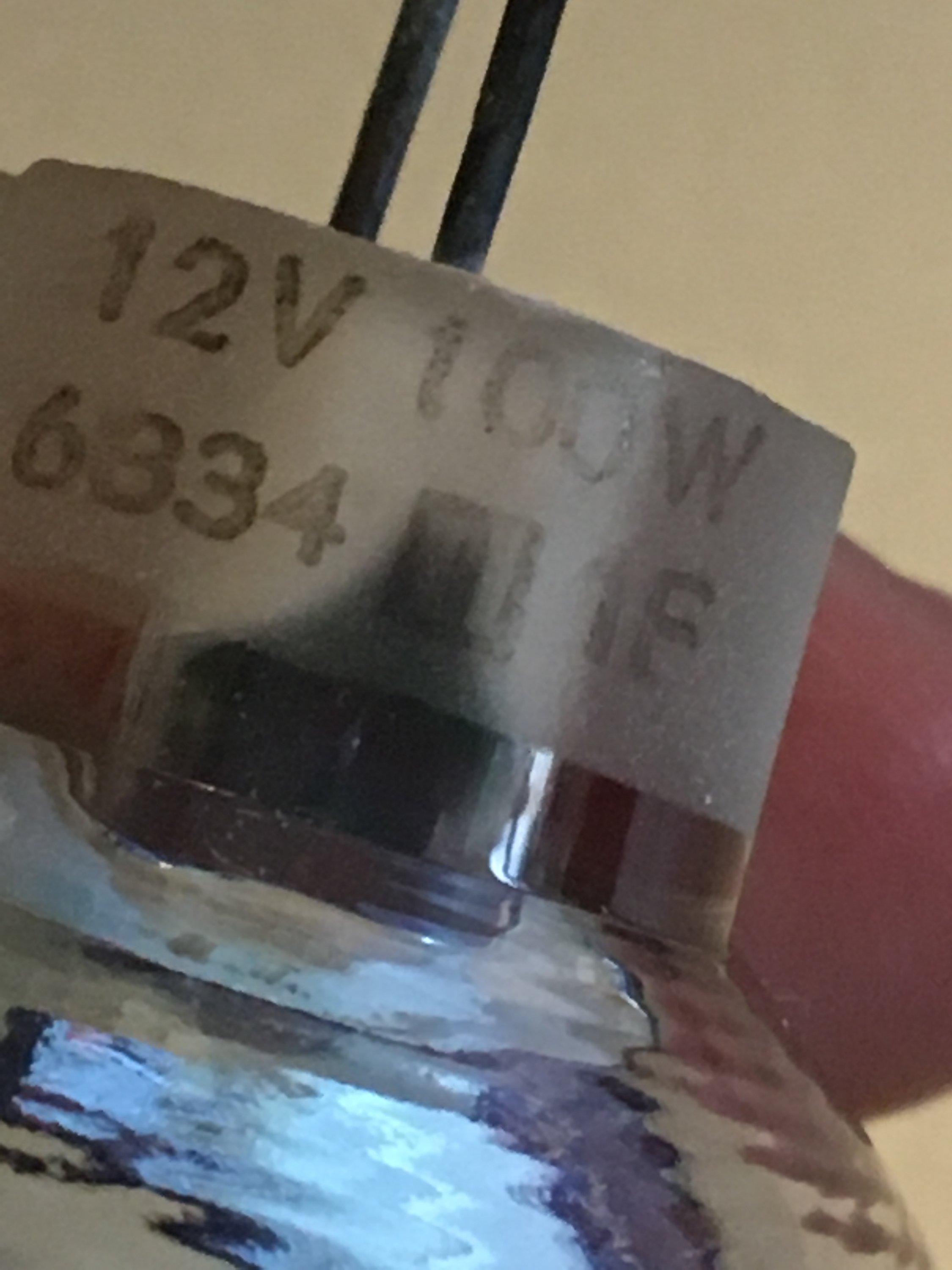

@George Nova Scotia : where can i find the 3 letter code? on the socket??

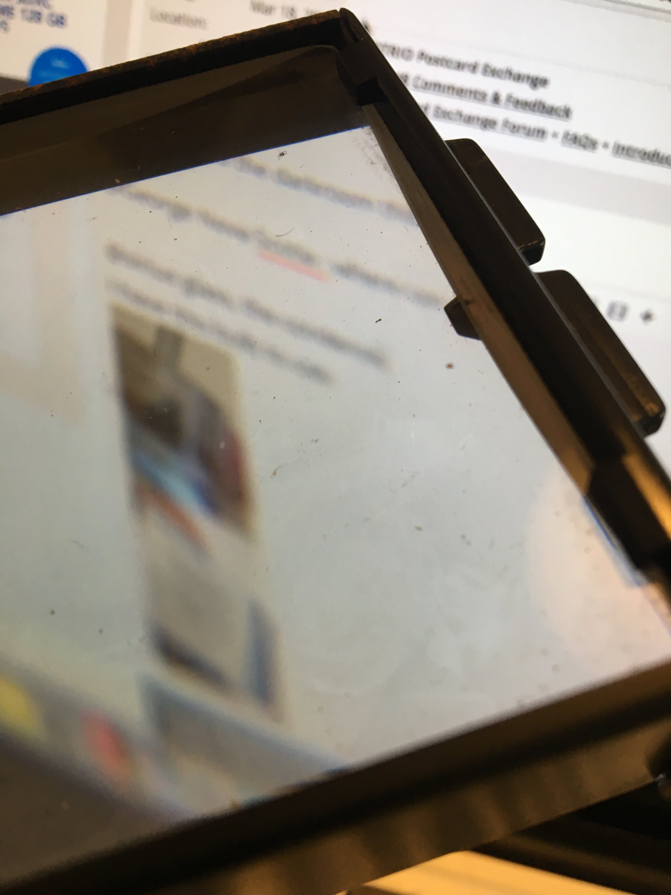

@Sirius Glass, the condenser, do you mean this condensing lens? and what should I do with these??

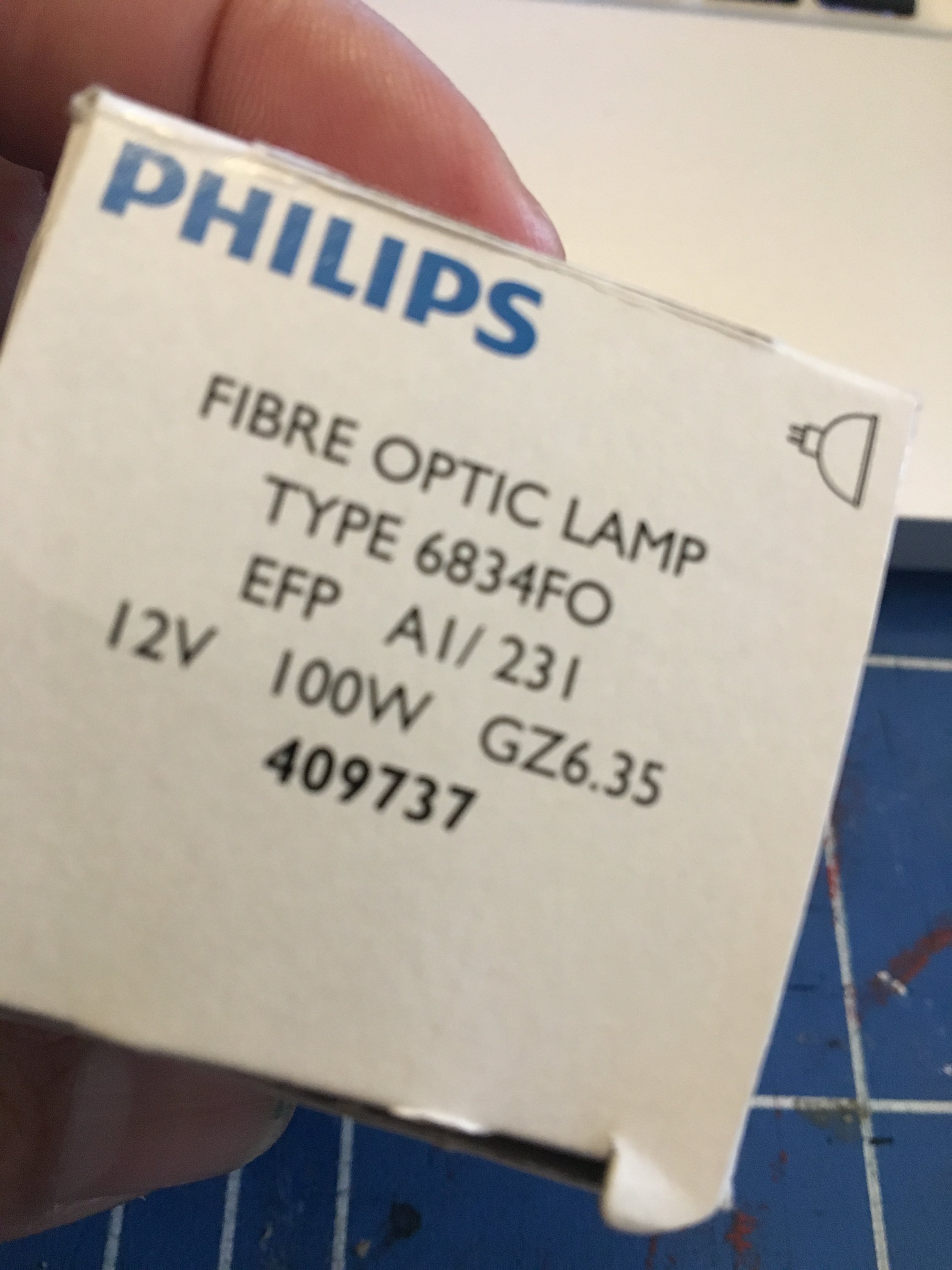

I have this bulb to use:
Leave the condenser alone, it could change the exposure time. Check to see if you have the right bulb in the enlarger.
Ok, I will leave the condenser alone. How do I check if I have the right bulb?? George said something about a 3 letter code, where on the unit/ enlarger can I find this code??
In another thread I read a halogen lamp will lose his power gradually. I need to buy a brand new bulb to be sure and check this. There are 3 bulbs in package, but I am not sure if these are used "and not strong enough anymore"
