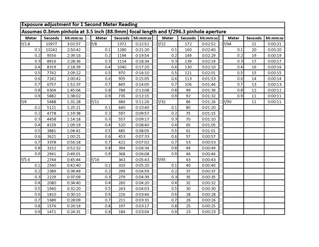

Here's the practical output of my spreadsheet. I have a laser-drilled .3mm pinhole and use a 3.5 inch focal length with my Graflex Super Graphic.
For those values, I set my Minolta IVf meter (time priority only) to 1 second and take a reading at ISO 3 (optimal for my enlarger paper and reversal processing).
The meter reads the aperture for 1 second. I look up the decimal aperture value in the chart to get seconds or hh:mm:ss exposure times. All very precisely calculated! :smile:
For those interested in the full spread sheet that calculates the precise exposure time correction factors for any pinhole diameter and common focal lengths, I put it for download at:

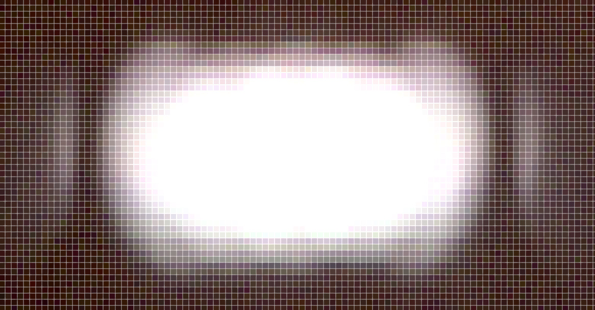

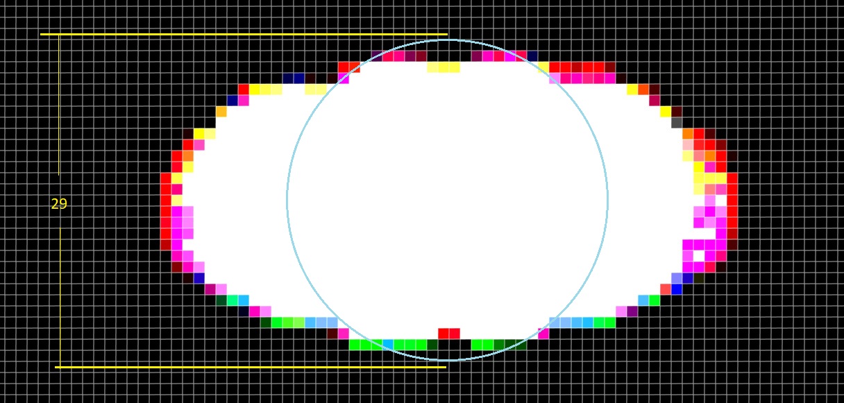

Don, just out of curiosity, how precise is that laser drilled .3mm pinhole? Laser drilling is a method of fabrication with perhaps a bit of salesmanship, not a guarantee of accuracy. Long ago I used a hand-held microscope with a measuring reticle to check home-made pinholes. Now a properly exposed high resolution scan of a pinhole on a desktop scanner might be more convenient for most photographers. At 2400dpi one should be able to measure to a few percent accuracy, good enough for practical photography.
That's an interesting idea!
I tried it and found the lateral distortion of my inexpensive scanner was pretty bad. Plus, the pinhole mounting prevented contact of the copper foil with the scanner bed. Backlighting the pinhole with a portable light table, inverted seemed to give the clearest results. I scanned at 2400dpi in close zoom and enlarged further in Photoshop so the pixel blocks could be seen. I boosted the contrast to reduce the fuzzy boundaries and drew a circle using the vertical axis to set the diameter, as there seemed to be less distortion. I counted the pixel blocks and came up with 29.
That's 29/2400 of an inch or .012 inch x 25.4 = 0.304mm for a pinhole with an advertised 0.3mm diameter. That's a pretty good result.
