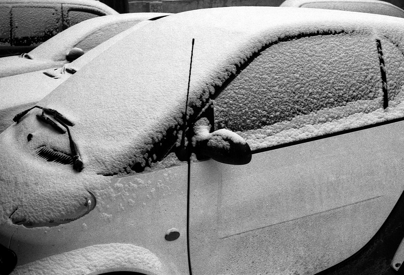

The car is film, but cloudy weather

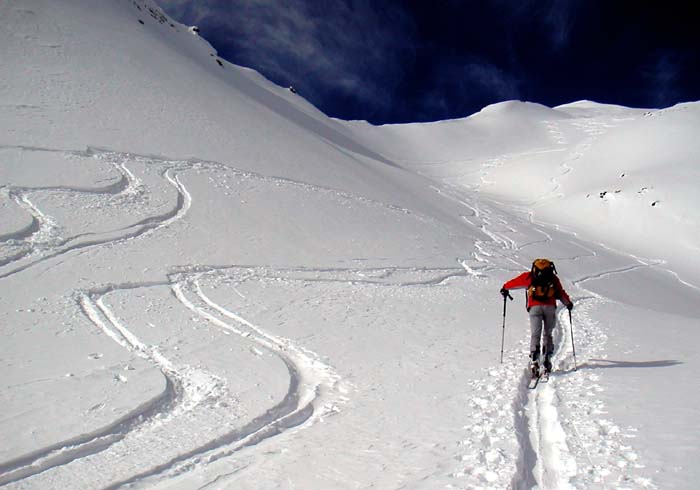

The color two -Alpes, snow & sun, digital

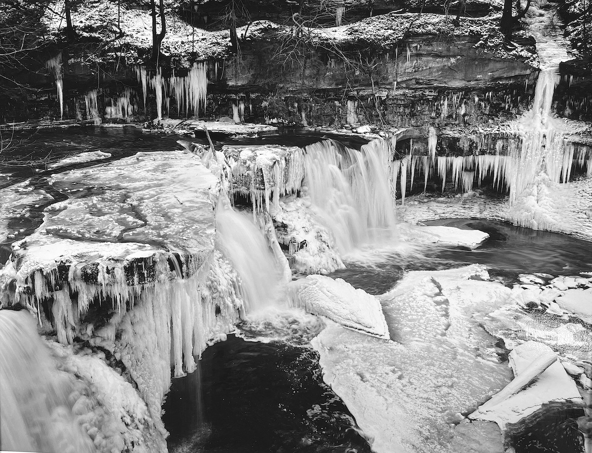

Don't over expose or under expose. Under-exposure will lose the shadow detail, and over-exposure will flatten the detail in the snow highlights. Looking back, I have very few excellent prints of snowy scenes that were illuminated by direct sunlight. Overcast lighting will make the negative easier to print.
The most important step is careful printing which may involve dodging, burning and or bleach to achieve an excellent print.

For the picture like ic-racer posted no need to make any compensation. For the white landscapes you will need it. If the main target of the photo is snow -you have to put it to the flat zone of the film curve to have details, but to make it white with details you have to overexpose. The main question- what are you metering? Snow, face, buildings... all together

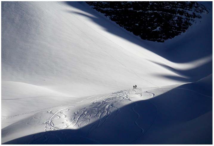

ic-racer's photo shows lots of gradations of white, but it's not a photo with sparkling snow. The suggestions for incident metering are right on the money.

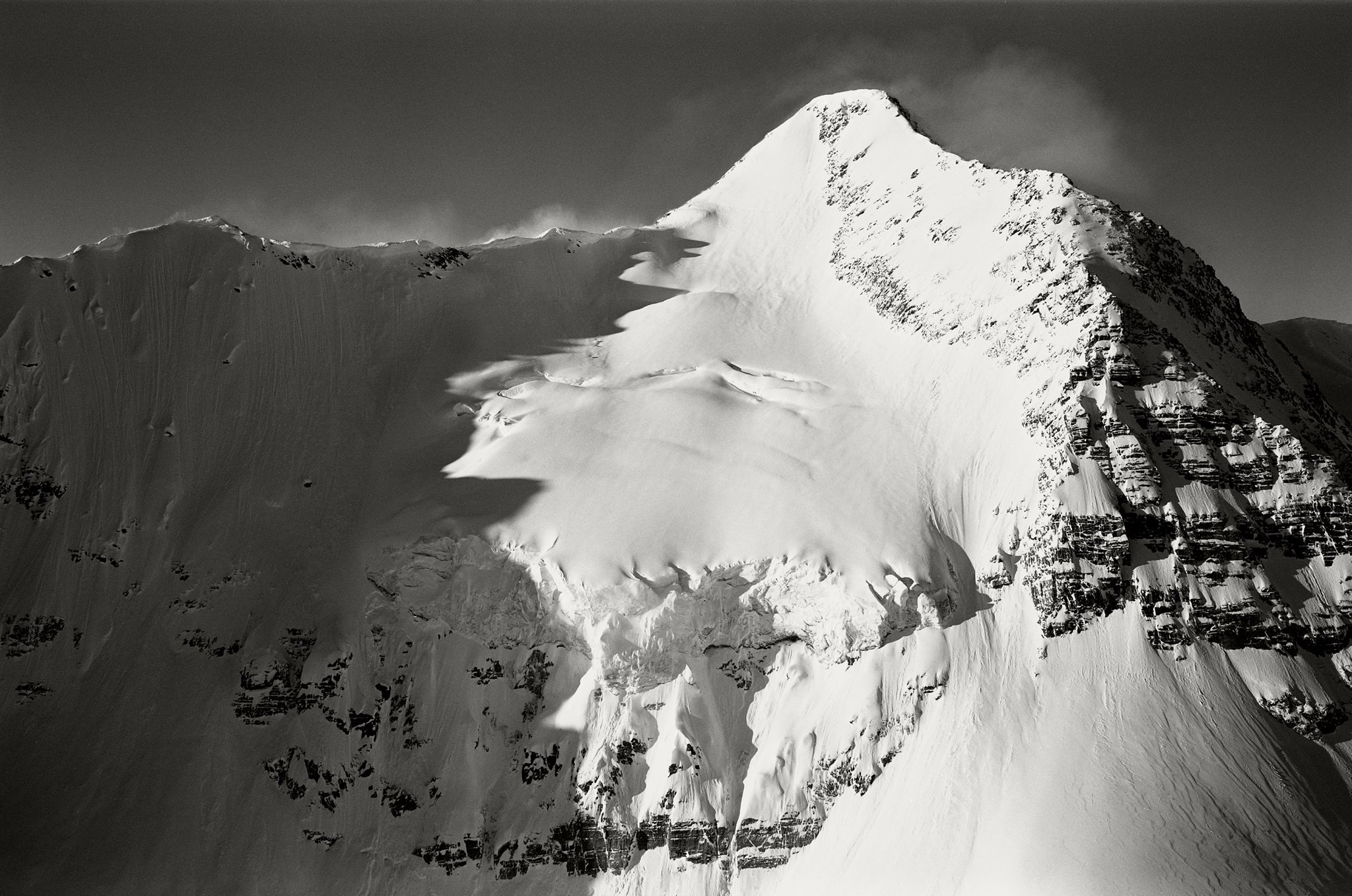

(Fuji GW690lll, Tri-X, orange filter. f5.6/ 1/250th...print on Forte FB)
