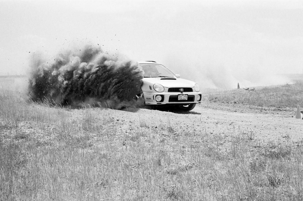

If it is shots like these with a white car I might not bother as the real subject, the car, being white shows up well.
A red lightens its own colour and related colours such as pale yellow grass so if the car is white then a red might lighten the grass as well and get it closer to the white car which is the opposite of what I think you are trying to achieve.
A filter won't alter the contrast in the sense that a higher grade of paper or a higher grade used with VC paper will alter contrast. However if it was a green car then a red will lighten the straw coloured grass slightly while darkening the green car so creating contrast between the car and the grass.

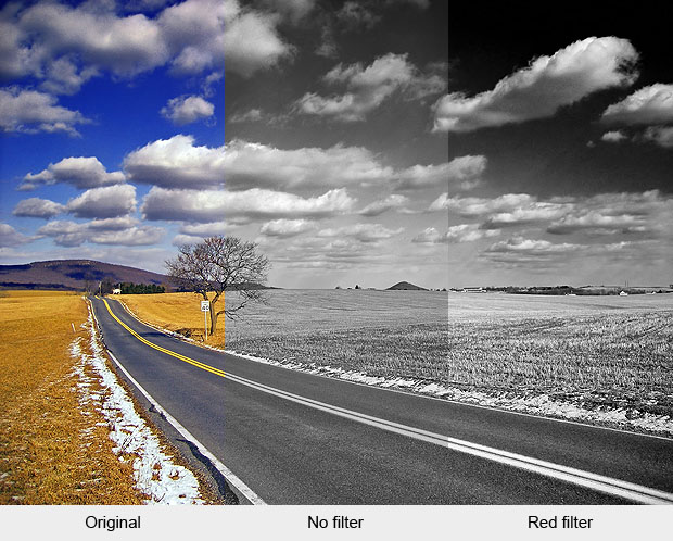

I thought that they did this. Am I wrong?
Red increases contrast, yes. But not directly and not always, only in scenes like this where it darkens the blue.
Where do you want the increased contrast? On that original shot on the first page, I saw no sky, it was just washed-out, I presume grey cloudy? Not much you can do about that with a filter.
What colour was the grass? You can darken that with a filter. Green grass will go darker with a red filter, yellow grass will go darker with a blue filter.

You are not wrong. That's a good example you posted of what a red does but you'll note that the red filter lightens the wheat/corn compared to the "no filter" shot and in the case of the car it would reduce contrast or as I thought you meant the differentiation between the car and its surroundings.
Great for skies but have a good look at what might happen to other colours in the scene before attaching the red.
