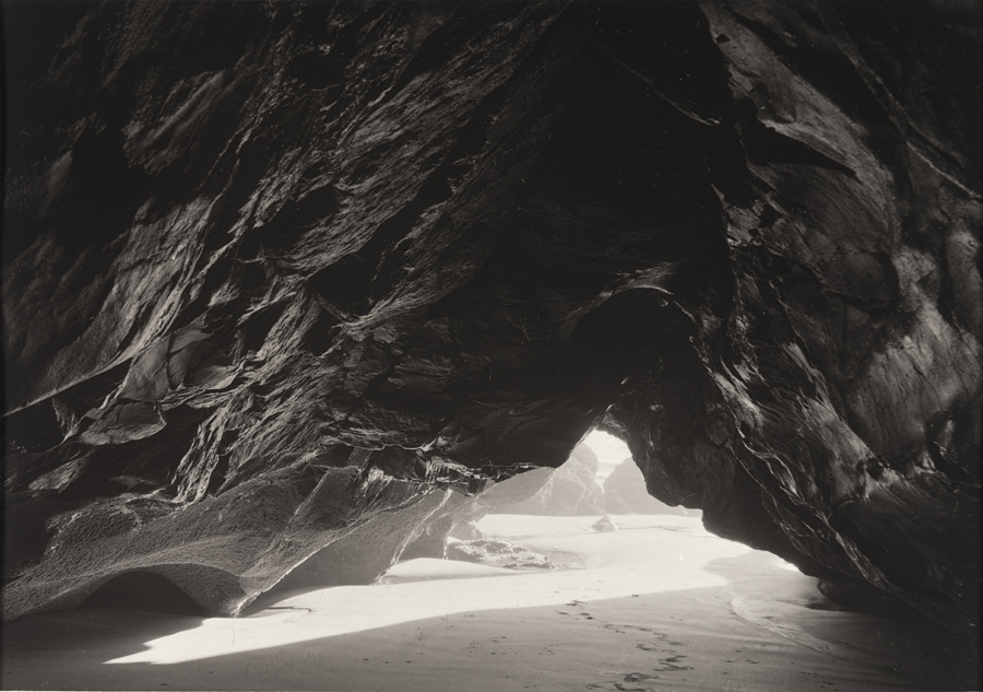

In scenes with the Subject Brightness Range [SBR] is fourteen f/stops, I can get that one film. Printing on paper takes some work.
About 13 stops SBR for this one. Might have been more...when the Pentax Digital Meter reads zero, there might be some darker areas. On the top end I got 13. Developed normally. I just happen to use a printing process that can grab all that info off the negative. But this is a rare extreme SBR. it would be very rare to find this range even under the redwoods wit hthe sun shining through.
This is a good example of what I meant by getting a large SBR. I like the composition and execution.

Thanks. The photographer is always in their photographs...and sometimes their footprints. The lowest part of the cave opening was just under 4 foot tall. Even tho this is an old image (mid-90s), I still remember being careful not to fall when ducking under that low spot carrying the 5x7...footprints are one thing, but a print of my butt in the sand is another.
