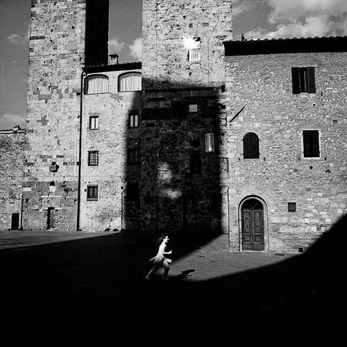

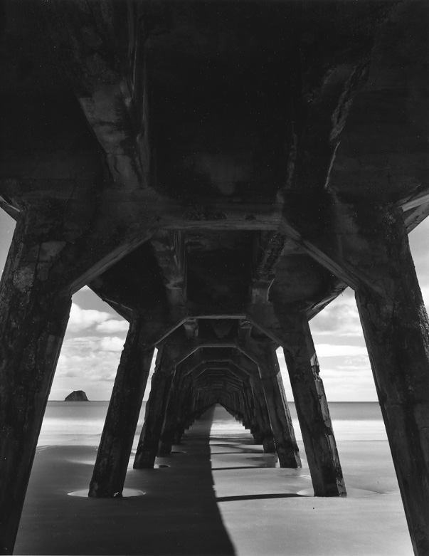

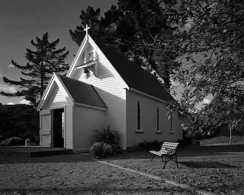

I'm trying to figure out what makes a great photograph which was made in bright sunlight; a print that makes you squint when you look at it. It seem to me that a lot of black & white photography is made in overcast or diffuse lighting. And while I've seen many photographs that have been taken is bright sunlight, only a few truly posses that feeling of bright sunlight. I have attached a few great examples.
Exposure:
Exposure in bright sunlight can be very difficult if allowing in-camera metering. Spot metering is a little easier. Is the key to a great sunny photograph the black detail-less shadows? Or the bright detail-less highlights? Or both?! Seems many photographers (Ansel Adams certainly) try to get as much detail in the shadows and highlights, compressed the tonal scale much, whether it be use of compensating developers, water bath, stand-development, etc. I find a great sunlit photograph to have black areas of detail-less shadows, though this is just my personal preference. Highlights can also fall quite high on the exposure scale, though through controls already mentioned can be controlled.
How are you guys exposing your sunlit photographs? Are you placing shadows on zone II? Maybe placing highlights on zone VIII? Reduced agitation in development most of the time?
Printing:
Then when it's time to print, I usually start with my lightest tone, usually a zone VIII in a sunlit photograph and find my exposure which makes it just visible on the paper, then use contrast to set the blacks. Many times though with my sunlit photos the whites are either too bright or not quite bright enough. It seems that it's a fine line between success and failure.
How are you guys printing your bright sunlit photographs? Are you letting some of your highlights go pure paper base white? Are you letting some shadows go to detail-less blacks?
I understand everyone's process is different. I'd just like to get an idea of other thoughts on bright sun photographs when it comes to exposure and printing.

This naturalistic approach is what I've used on many 'clear sky' occasions: Don't meter, lord don't spot meter. Just sunny 16 rule and let everything fall where it is. Everything should render as your eye sees it: sun reflected on windows will blow out, deep shadows will be black, and everything else should render faithfully. My rationale is that if I was drawn to photograph it, it should look like what I saw. The contrast is handled to my liking with development time, attempting to standardize contact prints. To get close to the images you've cited, forget about exposing for the shadows, forget about developing for the highlights. Set for sunny 16 and let the film do what it does.
For printing, my preference is the highlights on the church wood above should be perceptibly darker than the paper base (so you can see the border as brighter), but I think it's fine for the sun reflected in the window to be as white as the paper. Sorry if that sounds superficial.

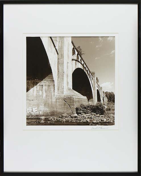

I'm surely no expert, but I would tend to take the whitest white up to just about blown out, but use a contrast that still goes pretty deeply into black. To some extent, contrast is a relative effect, painters create strong centers of interest by placing darks and lights directly adjacent. The same values separated by intermediate values don't appear as strong.
Not sure if this is an optimum example, a zapped bit shot of a "real print!"
As a photo of a photo, it's a bit wonky, and only the clouds approach a blown out white, but I think the fact that the direct sunlit concrete falls next to the deep shadow under the arches illustrates what I'm trying to say.
Hmm, exposure wise, I discovered after the fact that day I had set my meter wrong, partly compensated by a generous allowance for a yellow filter, so the negs were on the thin side, but close to my norm contrast-wise.

Excellent example Dave! This is the type of bright sunlight shot I am trying to master. Interesting concept about adjacent areas of bright and dark tone, it certainly is effective. I'm sure there was plenty of tone underneath those arches to the naked eye, but the way you've printed this has rendered it screaming of sunlight! It would be interesting to see another example of this print with lots of detail in the shadows. I would fear it would turn out to be a muddy print. Sometimes I suppose the limitations of film help to portray a scene as such in your example, or maybe we're so used to seeing bright scenes portrayed with empty shadows that this is what we've come to expect. Thanks for sharing!

it is interesting how we perceive light. I find the second example you gave to be very unreal lighting -- the shadows are far too black -- not what we would experience if we were there. But at the same time it is a wonderful image, with the girl running (escaping?) out of the shadows (which are rather ominous-looking in their darkness.)

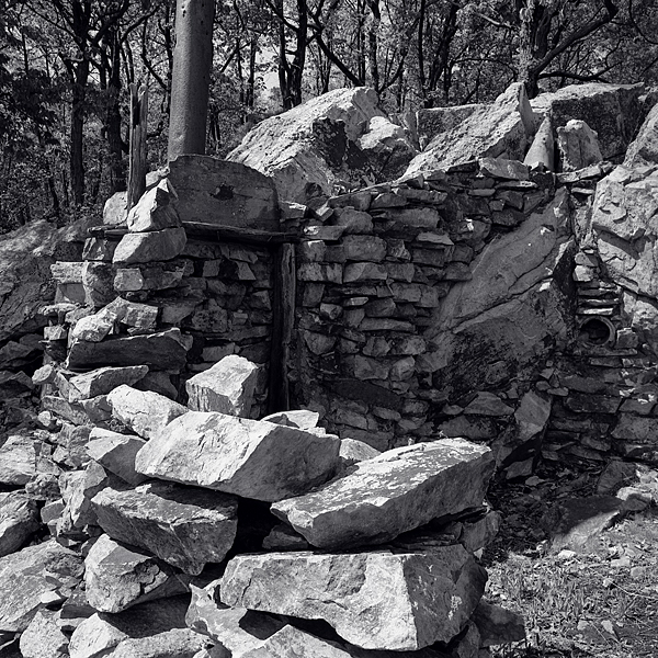

Here's a shot I took yesterday in blaring sunlight, around 2pm of an old stone cabin. It was shot on FP4 in Rodinal 1:50. Highlights on the rocks were placed on zone VII and the shadows on the inside were between zone II and III. I think the neg may be over-developed just a tad. This is only a neg scan, but I am excited to print and share as well.

You need to do a personal film speed and development test as their should be more shadow detail than in those images.
It's important to get the detail into the negatives, that way you can print them anyway you like and will have far more control at the printing stage.
