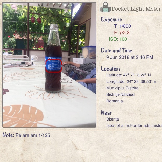

To make it easier to understand what light I was working with, here's the log from the app.

was the scene back lit ? i see behind the tables
aer green leaves is there a ton of light too ?
your pocket might have read a lot of the
light spilling in from behind the subject, and your
camera meter might have been reading more of the subject and the table
you have to take these things into consideration whenever you
use a meter or do sunn6 11/16 ..
sometimes you can take your meter and get closer to the subject so there
is less interference from "outside" what the photo is going to be about
backlit can be a couple of stops difference
