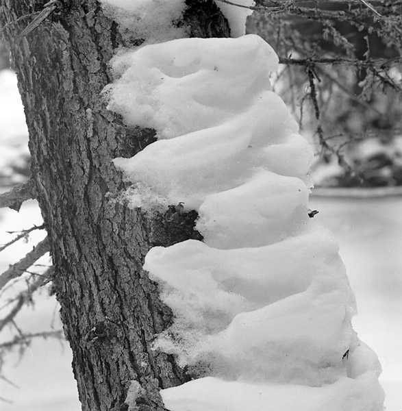

For snow shots I either use a green filter or no filter at all. I find using a yellow filter increases contrast to an unacceptable level. Even in shady areas. The green filter also makes tree trunks look better as well. I have included a shot I took last week on an overcast day using a green filter, HP5+ and souped in PyroCat-HD. PyroCat is amazing in how it handles snow scenes. Check my gallery for some snow examples.
