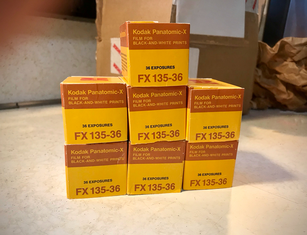

My karma must be in pretty decent shape - a kind person gifted me a few rolls of Panatomic-X this week via the mail! panatomic-x.jpg
This has been in a freezer all its life, and is dated 1982. Any idea just how much I should compensate for speed loss? I'm estimating its likely close to 8ASA now.
I'd start by shooting six or eight heavily bracketed frames under controlled lighting, cutting them out of the camera, and developing them. That will tell you everything you need to know for the rest of that roll and the other six.

I should have stated that this is almost certainly going to be my approach to it, but I wanted to solicit other opinions too :smile:
Generally, loss of speed with age is a result of age fog -- much of which is thermal -- and the need to expose more to get your shadows out of that fog. Frozen film fogs much less than film stored at even "film cooler" temp around 50F. Further, slow films fog less than faster films. There's a good likelihood that Panatomic, at near 40 years beyond expiration, will be just like new film, or have lost at most a fraction of a stop.

Thanks for that info, that's exactly the kind of thing I was looking for. I'm going to make a test of 6 or 8 frames, bracketed from 32ASA on, adding half stops.

I think that your specific Panatomic-X will suffer NO loss of speed. Use EI 32. I think that you will be surprised.
And I second Qualls' directive to shoot less than half a roll, but with the exception to shoot only one or two frames of a contrasty sunny scene with good shadow detail. THAT more than anything else will tell you what you need to know about film speed and development time. - David Lyga
