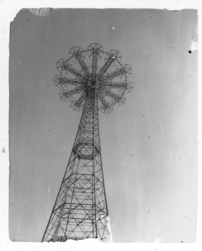

Thanks for all the advice and recomedations, I got my first image!

Congratulations Jaime! Nice print.

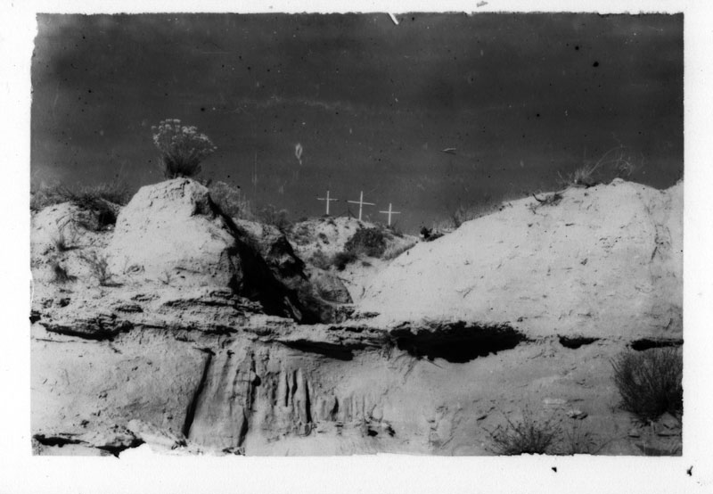

Thanks for the feedback, definitely the sliding and the frilling is my next thing to learn, in none of the prints so far I used the safe edge, I am worried about putting tape into the negative. Here is the third try at carbon, the second one was really dark and didn't stick well to the YUPO.

There are several ways to make safe edges without actually putting tape on the negative. The tissue should be about a half inch bigger than the negative all the way round -- and then the tape can go on the mylar between the neg and the tissue, on the glass of the vacuum frame, or cut a hole out of a larger piece of rubylith, etc.

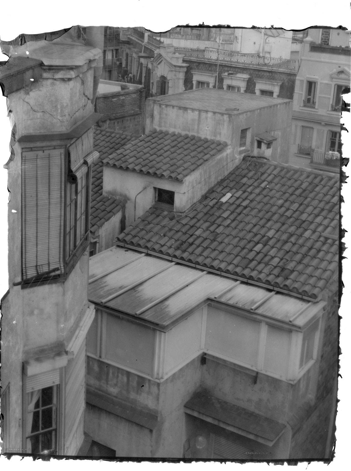

Not making my own tissue right now, bought it from Bostick & Sullivan. I think when I run out of the two tubes that I have I will try to make my own because I've been told by others that you can make the tissue thicker or with different colors. The thing is that at this point I want to keep it simple and build from that. Good point about the notes, I should be more organize about my times etc...I think what I would do is to keep notes for every print I do. You guys are very inspirational. Here is one of my 4x5. View of roofs from another roof in Barcelona, taken two months ago.

Now that's a view to behold! I'd be up there all day long taking pictures, are there more of these? You picked up carbon quickly and on your own, that's the way I did at first, after a workshop or two I expanded enough to get a more complete handle on it but at the same time the Internet is a great place to connect with some of the few people who actually make carbon prints. The interesting thing about carbon printing is that it seems more like printmaking than silver printing to me. It's hard to define but the process is very satisfying in a personal way. Carbon is slower and in a way more relaxing.
You have a lot of tissue to use before you will run out and then the fun begins all over again. It's interesting how some, like myself, proclaim that they will never make their own tissue only to suddenly decide to give it a try and then find out it's not that hard and is another part of the process that's relaxing and satisfying.
I like the composition of this photo, what film did you use there? Nice printing Jaime.
Curt
Thanks Curt, that was Efke100, I also have few more with Delta100 from the same roof, my primary location when I go to Barcelona, it is the deal when traveling with little ones. The process is really relaxing, I sometimes forget what negative I am printing towards the end of the process!
