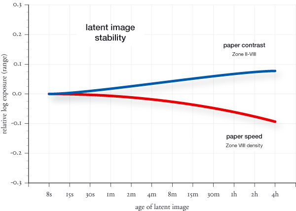

The latent image stability with film is amazing. Paper does not have the same stability. I don't know how long it will last, but the difference in speed and contrast between a 0 and 32 minutes delay can be seen in a side-by-side comparison.

The latent image stability with film is amazing. Paper does not have the same stability...
That's an eye-opener. Seems like 3-4 minutes would be a maximum time - very interesting.

I can only state my experience with Kentmere FP VC and Kodak Polymax papers. When doing a project, I often expose final prints in series of 5-10 and store the exposed paper in a paper safe. I sometimes have 30-50 sheets of final prints to develop. As luck would have it, sometimes I have had to wait a week or even two weeks before I could get back in the darkroom to process the prints. I could discern no difference to my eye.
What type of paper shows such a speed loss in just 32 minutes?
Jerold
This test was conducted in April of 2003 with Ilford Multigrade-IV FB for latent image times from 8 seconds to 4 hours. The speed loss was 0.05 log exposure after 32 minutes in Zone VIII density (0.09 absolue reflection density), which is roughly 1/6 f/stop of exposure. I'm certain one would not see that unless a side-by-side comparison is made.
Latent image stability is related to reciprocity failure, and hence, most obvious in print highlights (where it was measured). It will be different with different papers and possibly different developers, but I see no reason to expect drastic differences.
Some darkroom workers have reported that they saw a difference between test-strip densities and final print. I suspect that most of these reports are caused by latent image stability or the lack thereof, if a number of test strips were made in sequence but developed simultaneously.
To be certain, I suggest to conduct this test for ones own materials, but it is advisable to keep the time between exposure and development constant in order to ensure consistent results.

Thanks for the word of confidence, but my last post was unfortunately incorrect. Your post mentioning speed 'loss' got me a bit off track (my mistake). The speed curve dipping into the negative means that less exposure was needed to get the same print density, of course. Therefore, we are talking about a speed 'gain' with time. This happens for the print highlights but to a lesser degree to the shadows, which explains the extended log exposure range, meaning loss of contrast. It's a bit like a fogging exposure, if you know what I mean.
I remember discussing this with Ilford at the time. I'm not sure that the underlying effect is clearly understood. It was explained to me as 'propagating' exposure.
Sorry for the confusion, I had it right in the book manual (sigh of relief).
