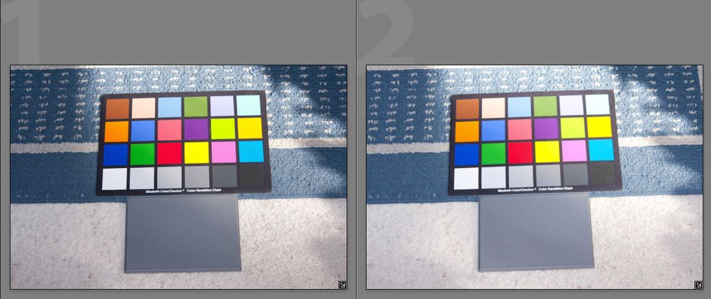

Here is Metz 54MZ in Canon eTTL mode (left) vs. in Auto flash mode (right)...
...the fundamental shot ISO200, 1/200 f/11 on the left and ISO200 1/40 f/11 (Av mode selected speed based upon changing lighting) would have been -4EV underexposed in the shaded areas without the flash.
Since the current discussion happened to be about fill flash, I deliberately chose a fill flash situation (although the sun lit are is a bit overexposed) to illustrate, but the ambient lighting from outside was variable, making a truly direct comparison challenging to accomplish.

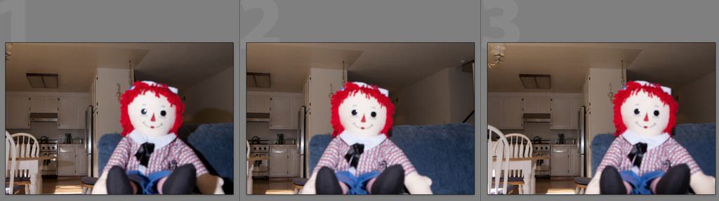

I thought I would do a brief test of the above theory, about photosensor Auto vs. TTL flash. I think the complication is the generalization about 'TTL flash measures a certain area typically at the centre of the frame.' In the case of Olympus OM-4, the TTL sensor reads the film plane when the shutter is open, and tells the flash to cut off, and I do not believe there is a bias to the center of frame. In this test, I used a (gasp...) digital camera with photosensor Auto flash, then with nTTL. And to see if there was any bias toward center of frame in nTTL, I took a shot with subject centered and then with the subject definitively NOT at center. In the case of this camera, TTL is supposed to be biased to the AF zone(s) at the focus distance...which in this case I used center AF point but then recomposed shot 3 framing, leaving the AF point on top of the background!
I see no difference in photosensor Auto vs. nTTL flash.
