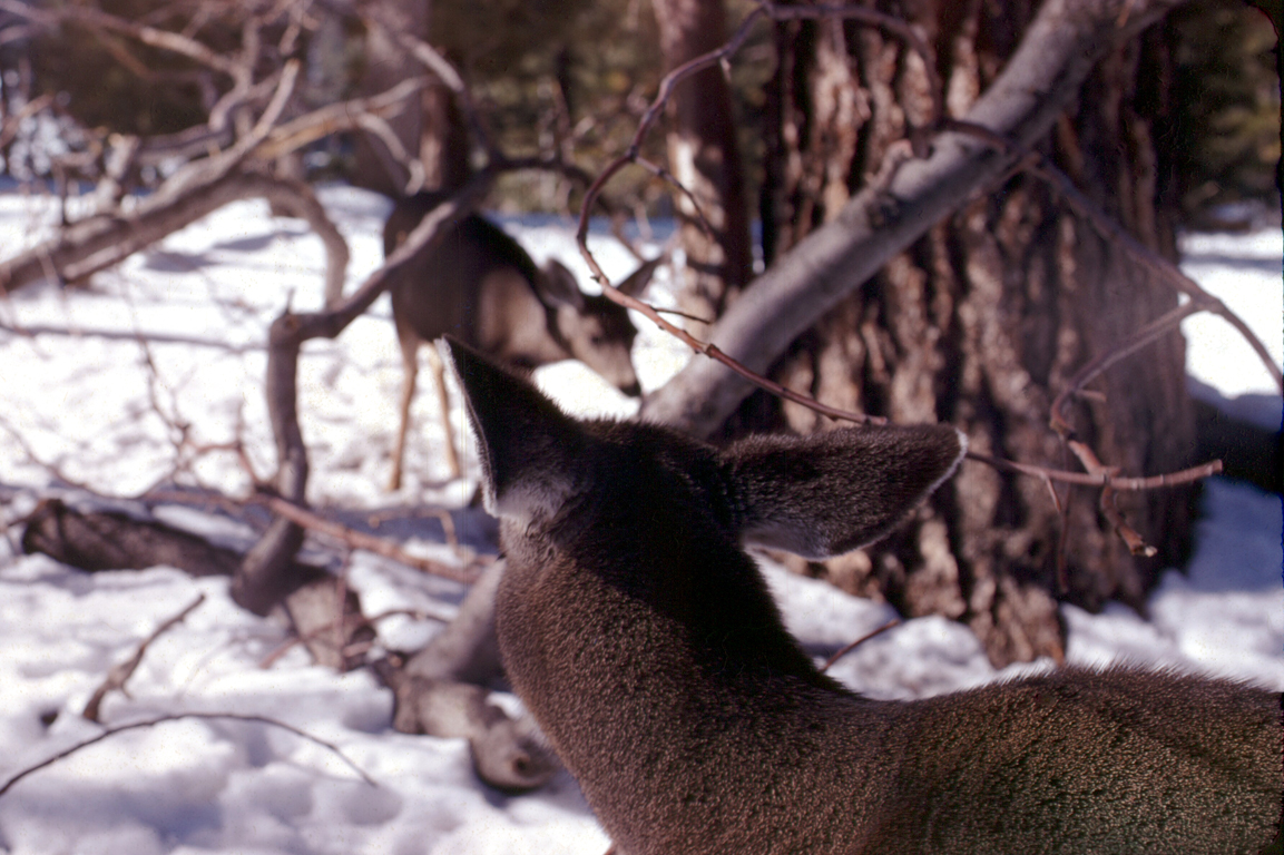

Two mule deer, Big Bear Zoo, 1975
Reading your post reminded me of the amazement I used to feel when I projected my first Kodachromes. I'd entertain myself for hours focusing in and out on the sharp bits of the few good slides I took. It was so much fun seeing furry ears and sharp individual hairs. I daydreamed about getting this close in real life. But because I know film can do this, I enjoy the work of photographers like Art Wolfe and Jim Brandenburg who have taken the time to get close-up portraits of animals in the wild...
