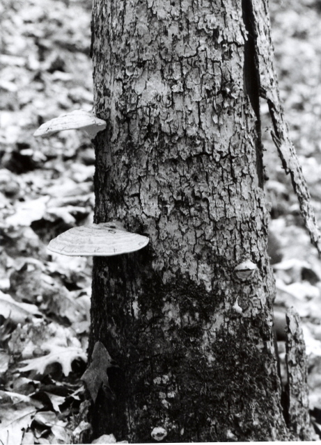

I've been shooting some 120 TriX expired in 1980, some fog, but sweet none the less.
