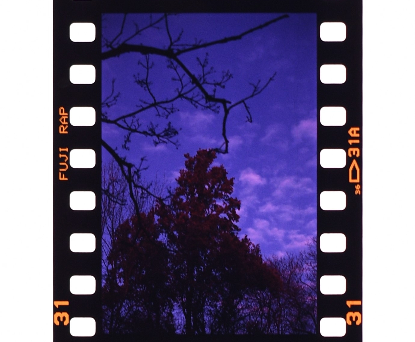

I've recently purchased several rolls of expired slide film, a mix of Fuji Astia 100 (exp in 2006), Fuji Sensia 100 (exp in 2004) and Kodak Elite Chrome 100 (exp in 2007). None of them were cold-stored.
I've only shot one roll of Astia 100 and the slides came out with a heavy magenta cast. The roll was shot with my Nikon F100 at EI 100. I certainly expected some degree of color shift due to the way these were stored and their age, and I was fully aware that the results from these films would be unpredictable.
The attachments are just quick shots taken of the slides on a lightbox, to show what the magenta cast looks like. Some photos exhibit the cast more than others.
For the remaining rolls of Astia what would you suggest in order to reach a more neutral-looking color palette? And would that approach be applicable to Sensia and Elite Chrome, too? Or do those exhibit different color shifts?
I have never used one but read about CC gelatin filters, could that be a solution? Will green alone be able to balance out the magenta? If so, what strength, CC10G or CC20G or much stronger?
I intend to buy a slide projector in the near future, this is why I would like to make all the effort to get it right at the taking stage.
Thank you for any advice.
Yes, gels can help for sure. They may/will add some flare though, but that won't be an issue in all lighting setups. Just give it a try.
By the looks of it you've got both a magenta and a blue cast, so you'll need a green and a yellow filter. How strong - I don't know. You'll have to experiment.

Ah...I'd strongly suggest just buying fresh film. This is always going to be a compromised situation, after all.
Thanks! I'll look into green and yellow gels. I'm sure this will be quite an experimentation to get the proper filtration figured out at the end. But if these get me in the ballpark of more balanced colors, I'll be content.

There are two methods to modify the color balance: you can add KBr to pull down all shadows, and you can add (much smaller) amounts of KI to lower shadow only in the top most layers of your slides. If you have larger stash of these films, it may well be worth experimenting.

IIRC, colour balance is also affected by CD pH and raising it shifts it to green. Iodide content affects the yellow - blue balance, because it primarily affects the top layer.
Crazy idea (?) - has anyone tested the possibility of using colored filters to adjust the color at the time of projection? Obviously some care would need to be taken due to the heat produced by the lamp, but...? Am I right to think that if a filter can be found to produce good results when put on the lens when shooting -- then that same filter might be approximately correct for projecting slides taken without the filter?
My guess is that each emulsion (Astia, Sensia, Elite Chrome) is probably going to need a different color filter, but that is just a guess.

Place the filter in front of the lens; there's no heat issue there.
The main problem I foresee is that the whites will be tinted by the filter. Might be a bit odd looking depending on the scene. But in principle the approach should work!
That's the thing: many "problems with color cast" eventually turn out to be "problem with color crossover", and there's no filter for that.
Also: a filter can only darken. If you need a strong filter during projection, your slides will not look very bright.
As suggested I would use fresh film. If you want to play with the outdated film you might want to try some of the suggestions mentioned. I'll offer another one. Scan the color shifted ones and open in PhotoShop (if you have it) and while keeping them in RGB change to black and white then go to filters > neural, select colorize and see what comes up. If close, check ok to send it back to PS where you can tweak as needed then print or do as you please with them.

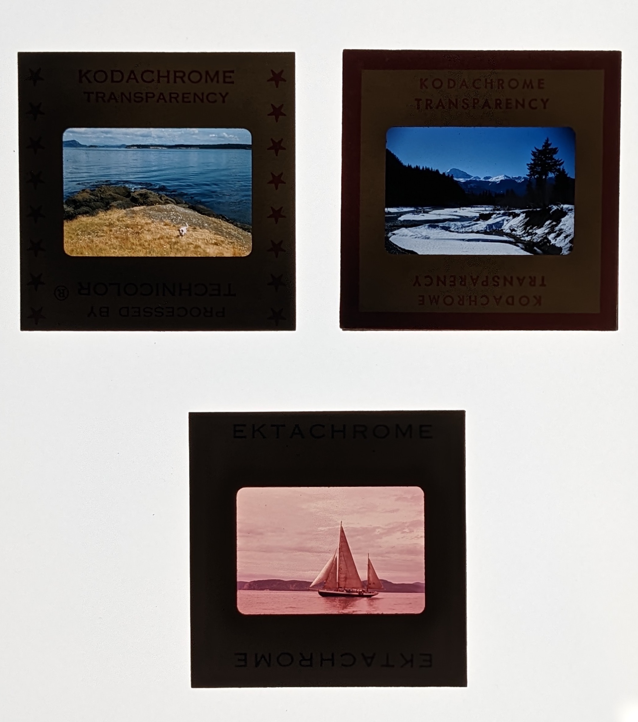

An unrelated side note: exposed Ektachrome does not age that well either. I recently got hold of some equipment from 1950's, and you can tell the color has faded on the Ektachrome but the Kodachrome are totally fine.
Ektachrome has improved stability, now, compared to previous generations. Kodak says it will last at least 80 years, without fading.
