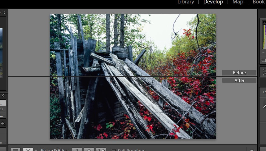

Here's an example of some of the blue color cast, this is the Ektacolor Pro exp. 1999.
