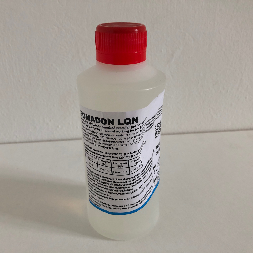

Hi everyone,
today, I bought two bottles of Fomadon LQN because it was available and I needed developer fast. Once home, I realize that the expiration date on it is December 31, 2023, which was not mentioned in the site that I bought it from. This wasn't mentioned by the store employee when I picked it up either. Would you return it? Would it be ok to use for a couple of extra months after the expiration date?
Side note: I seem to have bought their last two bottles because it now shows up as "not on stock" on the site šŸ™„
Thanks!

The containers seem intact, even if they always look like this šŸ¤·ā€ā™€ļø
