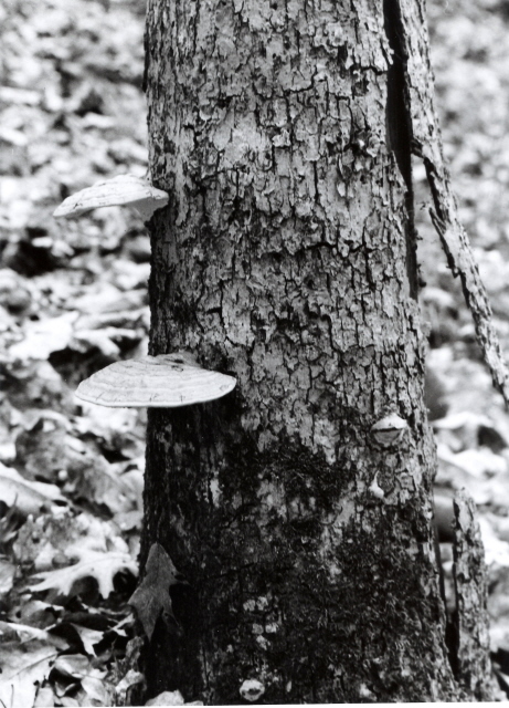

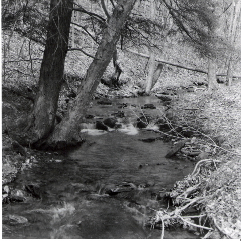

I've been shooting TXP expired in 1980 at half speed and developing in Rodinal(1+25) for whatever time given for full speed. No mater what, base fog is present, so shoot it to take advantage of the effect. These were shot using TXP120
