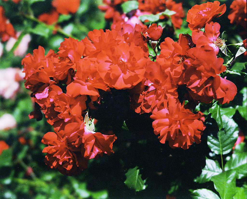

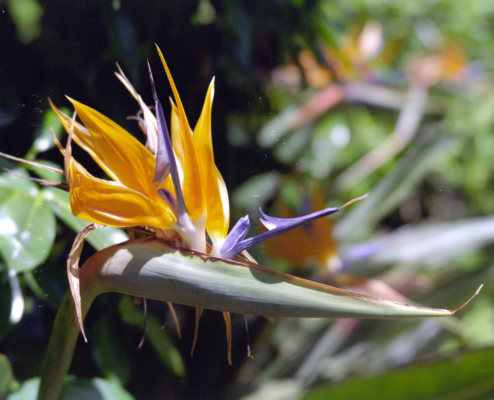

Here are two example of scans from expired (more than 20 years) Konica VX-100, These are my own images not from the friend. I am not an expert in scanning. These are unadjusted scans.
It's commonly agreed that bad expired films will be grainy and foggy. I don't see that in my two images here. Does that tell the film despite being long expired is still decent? These were from about a month ago.
No. It's impossible to judge on the basis of these images how well the film has fared since it expired. Try something with skin-tones or a more expanded color palette. Your flowers are pretty, but also form subject matter that is deceptive in the sense that things must be horribly wrong before colorful things like flowers start looking problematic. This is different with subject matter that we more easily recognize as accurate - skin tones, neutral greys, gradients from grey to white (e.g. cloud formations in daylight) etc.
For instance, the roses look nice and red, but is that the actual same red hue they had in reality? I'm virtually certain this is not the case, but I can't be sure since an absolute reference is lacking. However, if the red isn't accurate, try to fix it and the green will go wonky.
Interestingly, the roses are deeply saturated, while the other shot shows very muted colors. Part of this is due to lighting differences, but these don't explain everything - e.g. the yellows and violets in that particular flower at that stage of bloom tend to be more saturated. This suggests that in scanning, between these frames considerable differences exist. As a result, it's unclear what we're really looking at when we're judging color - the aptness of the scanning software in adjusting the colors, or some quality of the film? In case the latter, how come it's giving very high chroma results in one case and lower chroma output in another?
So no, this doesn't prove much, except maybe that flowers are pretty and you're evidently pleased with how they turned out. That's OK, but that's not a solid absolute benchmark to judge the performance of a photographic medium on.
Foggy, yes. A grainy look is a consequence of printing or scanning through that additional density. However, the real problem is crossover. To an extent, this can be compensated for even by the scanning software itself, so film that has definitely gone wonky may still look (sort of) fine on your scans. It'll be impossible to print well optically. Moreover, differences tend to become painfully clear as soon as you compare expired film side by side under the same conditions with fresh film.

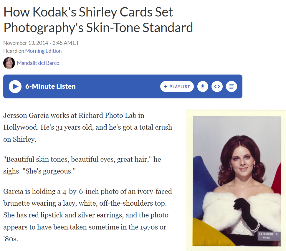

“this” being correct - no standard, I assume or am I incorrect? So who was Shirley? LOL
:smile:
The problems I’ve experienced with bad rendition of skin color often seems to be the separation between photographer and print finisher. The former can see reality while the latter has to guess and assume.
{Moderator's Edit: I tried to replace the Media link with a web address and image, because the "Cookies" approval box was driving me crazy - but had no success!}

The legend is that "Shirley" was the name of one of the first Eastman Kodak employees that served as a model for these calibration standards.
When I worked as a colour printer, our customers were all professional photographers, and most of my work was wedding or portrait photography, with a smaller amount of commercial photography as well.
Many of our customers photographed weddings for members of the Chinese community in the area - many of whom were multi-generational, with the older generation having immigrated from Hong Kong (mainly) and the younger generation having been born in Canada.
Our customers - the photographers - frequently had to deal with an interesting sociological issue. Their older generation Chinese Canadian customers tended to prefer prints with skin tones that were more "Caucasian" and their younger, born in Canada Chinese Canadian customers tended to be happier with prints with skin tones that were more (Hong Kong) "Chinese". No doubt those preferences reflected the differing experiences of the different generations.
From time to time we redid prints that adjusted those skin tones to match one of those two preferences.
The various "Shirley" negatives and prints reflected the customer bases of the labs that used them - they differed around the world.
They no doubt lagged behind societal changes, even though over time they did respond to those changes.
FWIW, due to the distribution of the population in our area when I worked as a colour printer, I was much more attuned to "Caucasian" and (Hong Kong) "Chinese" skin tones, but I did have some experience and familiarity with skin tones from people with roots in the Punjab region of the Indian sub-content, so could work well with those.
I'm not sure how well I would have done back then with "Black" skin tones - the population around here was tiny at the time.
In any event, I'm much more able to pick up a colour cast on a skin tone than just about any other subject.
The other thing that I always find funny about references to "Shirley"s is that my mother's name was Shirley. In a youthful world where matters photographic were almost omnipresent, it always made me smile.
You make a good point… in some communities especially, self-perception of skin color and desired rendition of skin color in photographs can be very different from either others perception or reality. That makes the challenge very challenging. If the challenge were only color cast it would be a lot easier.
