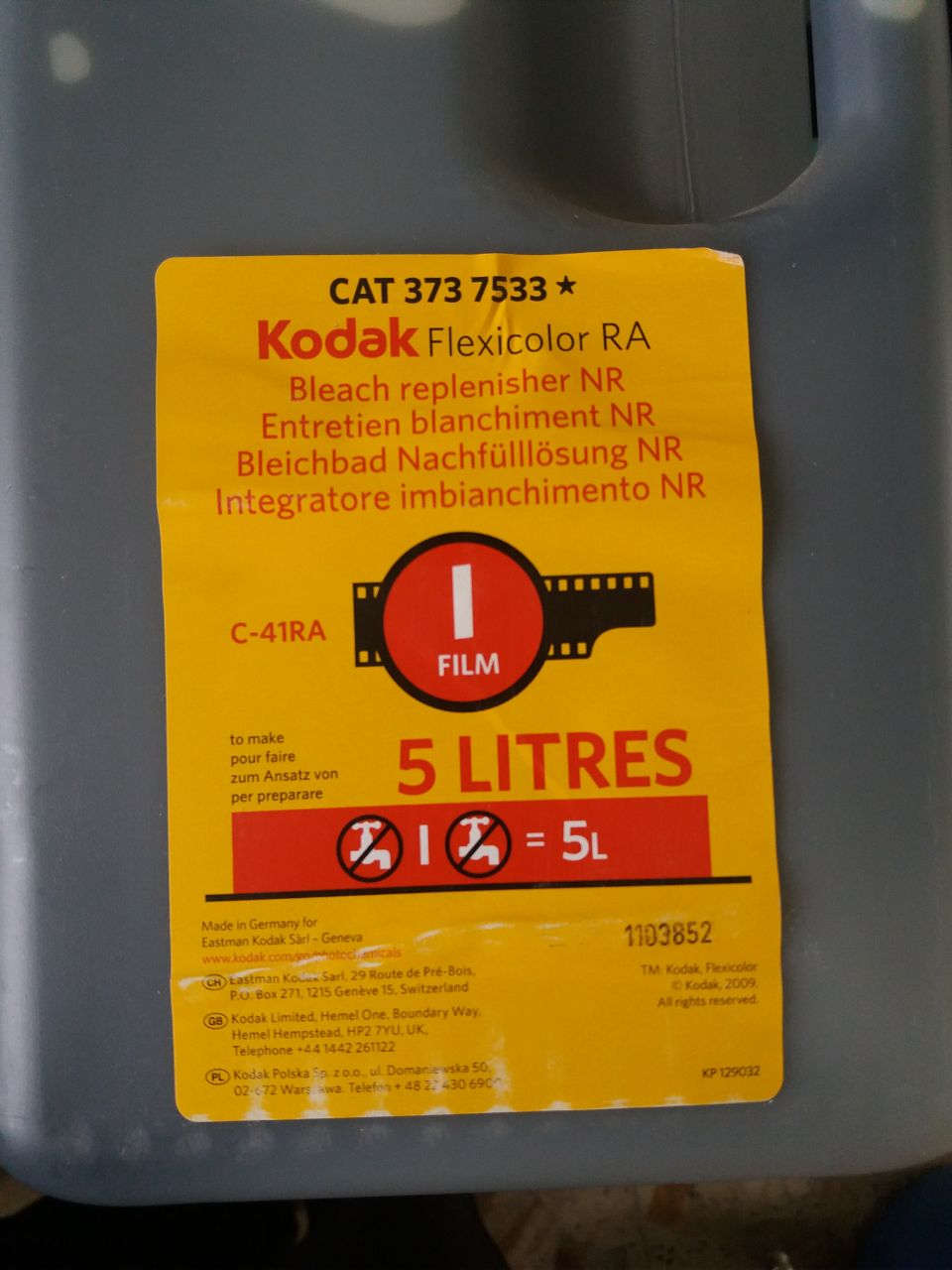

hi i have kodak bleach replenisher nr cat 3737533 if its need use starter or no ?
tanks
