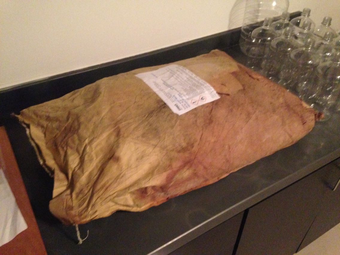

All hail Flavio, the owner of a 25kg bag of benzotriazole!
Hahaha! I am the king of the world! :D
Cheers,
Flavio
P.S.: The bag is plastic on the inside and has no holes. It's perfectly sealed, though it's not good looking.

There is Benzotriazole and 5-Methyl Benzotriazole. Both act similarly, but the latter is a bit less soluble.
Ron,
The label says the CAS # is 95-14-7. Sigma-Aldrich says that's Benzotriazole, 1,2,3-Benzotriazole or 1H-Benzotriazole.
So, I believe I got the right stuff. Can you confirm?
