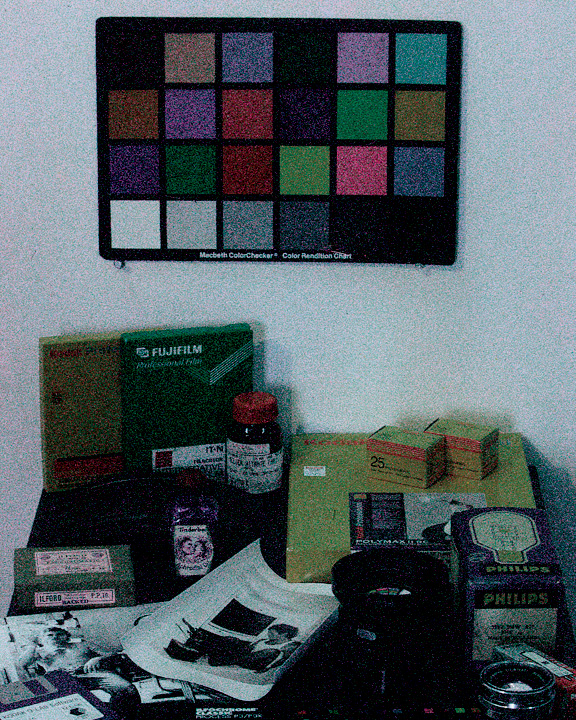

This is a scan from an RGB screen over ERA 4x5 film. The test is a failure. Perhaps RGB screens will work on other films however my results from ERA 100 using a linear RGB screen just don't look as good. THIS IS A FAILURE.
Note : in my RGB screen the colour values of the RGB in the output file were diffrent to the values of my RGB in the RYGCB screen. Primarily using this method i think the addition of a yellow has significantly improved the screen

My only advice for anyone wanting to get into this is A, Start by making easily separable DIGITAL Screens in a Linear Aray. Experiment with film types and experiment with the Tone of your Red green and Blue and if you want to venture down my track yellow and Cyan. perhaps in time if i experimented more I would find a combination of RGB and a film type which works well together and the Yellow and Cyan wont be relevant. From my own testing TMAX 100 and Tmax 400 using this method were disasters! though the bulk of my testing has been on ERA film simply because its been a cheap yet effective medium to experiment with. Also its base if very clear and the BMS when reversal processed has a good tone to it.
After perfecting linear (which I certainly haven't yet done and dont think i will) I would suggest moving onto slightly more complex RBG pattern on a digital
screen (such as a diagonal linear screen) then onto something more complex before delving into a complete randomization of the screen pattern.
oh also get a colour chart, a neutral wall and some very colourful items to use as your tests.
It's very interesting that the RGB screen was such a failure. I can't reason why...
Thanks for posting your examples, they are a great benchmark to set (the first example that is).

I liked your failure most. Look at the colors at the chart , how many times a person get these colors from his pictures ? If my autochrome will be the same with digital perfect picture , Why would I invest on it. Your failure says that there can be thousands of rare colors will be produced with these screens.
It is what I wanted most. It has the Belgian , French cartoons colors , not picture perfect Tin Tin.
Find Adele Blanc Sac comics at internet , dark classy colors and phosphore colors will always inspire me.
I will reread the posts and investigate the reasons of these colors.

From my POV Steve, the R/G/B example looks a bit dark. I think that a bit more exposure would clean it up quite a bit.
PE
Scanners tends to give such a grain when the film , image is dark.
