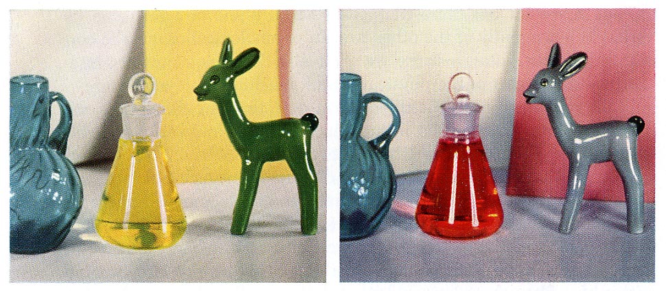

Here is the classic set of photos that illustrate the fact that white light is not always white light.
The picture on the left was taken with the equivalent of daylight. The picture on the right was taken by fluorescent light with a discontinuous spectrum. To a human being, both scenes would appear to be pretty much identical due to the adaptability of the human eye.
To film, the scenes differ considerably due to the fixed spectral sensitivity.
This is why it is more accurate to specify film as being pan sensitive meaning that it has some degree of sensitivity to wavelengths between 400 and 700 nm. The sensitivity profiles actually vary from film to film.
White light may appear to human eyes as white but it often is not. Especially if you compare photographic results to what the eye might see.
Narrow cutting filters or color correction filters assist in many cases in alleviating problems like this.

Nevertheless, both illuminating lights appeared "white". This is the reason we do not use the term "white sensitive film" which is the reason I commented in the first place. The correct term is and remains "pan sensitive" or "panchromatic". The human eye can adapt, but film cannot and so we use a film centric term to describe a film. Simply that and nothing more. If you don't get it, then too bad.

I might add to the above that similar results could be obtained by a continuous spectrum with peaks, such as Fluorescent lighting, which also appears white to the eye, but gives different results on film.
And, this illustrates that you are the one who is confused. You appear to insist on applying to both the eye and to film, the same "nomenclature" namely "white sensitivity", when in fact, you must apply at least two different definitions. And, I must add that when I see something like this in a post, not knowing the persons background, I'm sorry but I just have to dismiss it. Your statements thus far are totally off the mark compared to what is used as common nomenclature in the industry.
