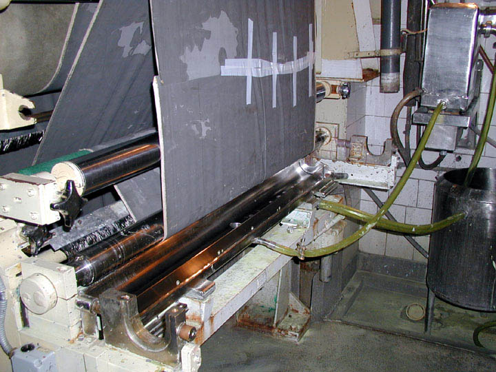

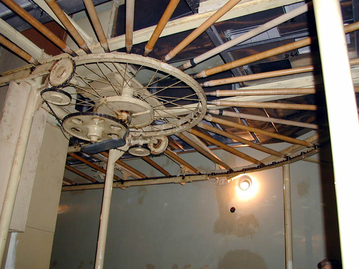

Here are some pictures I took at Fotokemika (Efke brand) while we were testing the new emulsion. There are pictures of the trough coater, the drying tunnel (first half) with the coating foreman (on left) and our customer rep. Also shown is the bull wheel which turns the corner, and the wind up station at the end. The drying tunnel is horseshoe shaped going out about 100 feet, around the bull wheel, and back to the windup station (Pictured with myself).
The trough coater picture shows a ultrasonic debubbling device on the wall. The emulsion is pumped through that, into the trough, and it overflows the trough continuously. The roller is lowered to the surface of the emulsion, and the web is started. Pictured is a rubberized cloth leader used for threading the coater. Up above is the chill station, and an over coater used for putting a hardening overcoat on - we didn't use this as the matrix film is unhardened. After that, a few people working on a cat walk gather the loops and attach them to clips on the overhead track. The loops travel slowly out to the the bullwheel, and then back to the windup station. Temperature and humidity are controlled along the way for ideal drying conditions as the film moves along.

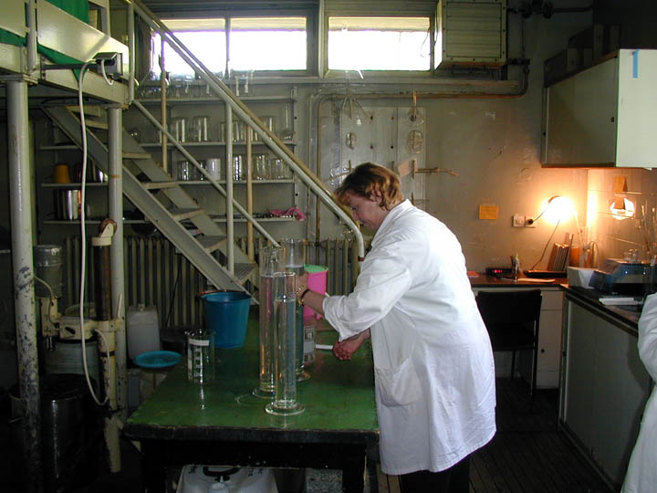

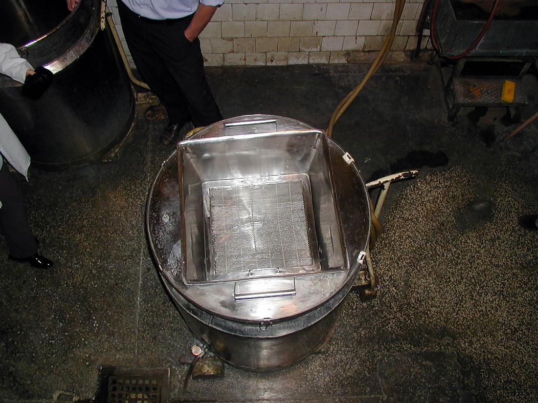

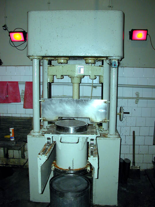

Also shown is a technician mixing the silver nitrate for the small test we ran, a vacuum filter, a large noodling press, and a sensitizing test. There is also a picture of a small mixer - used for precipitation during small tests such as we were doing. They had much larger temperature controlled mixing vessels. They had tubes running through the gelatin solution which controlled the temperature while precip was happening. They could match the temperature profile that I used while developing the formulation here in the US.
They would coat glass plates frequently while sensitizing, expose them while wet to a test pattern, and process them. They would run into the emulsion engineer's office with film boxes with the processed wet plates, and she would inspect it for a particular type of colored fog which indicated that the ideal sensitizing period had been exceeded.

That is very interesting about de-bubbling using ultrasonics. I guess this technique might also be used on a small scale. I have heard of a vacuum (low pressure) being used to de-bubble viscous liquids but not ultrasonics.
Emulsion.
Kodak uses a mixture of filtration, vacuum and ultrasonics.
Each lab had a small ultrasonic setup to debubble coating melts prior to use.
