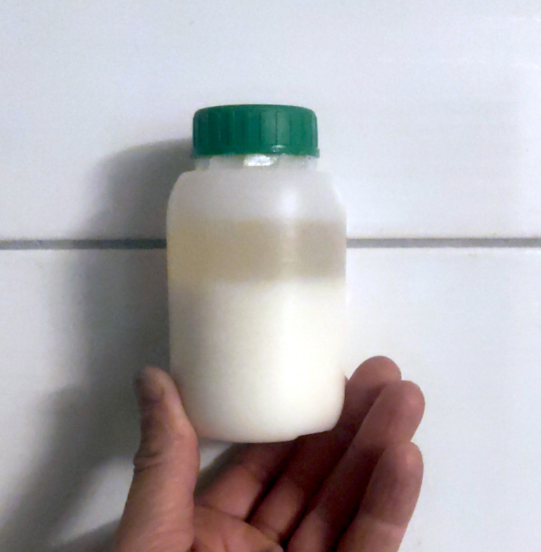

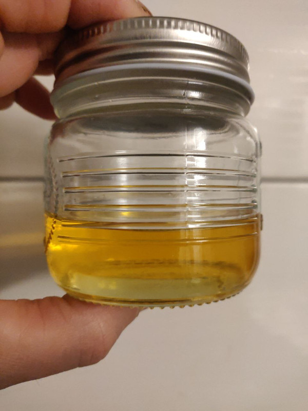

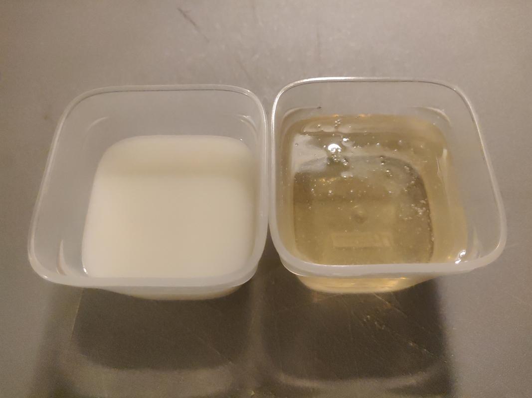

With this DCM18, sodium metaborate dissolves, it seem to reach point of saturation as a trace stays, neglieable, but then ascorbic acid didn't dissolve. After repeated long stirring and warmed a bit more around 90°C. The result is a creamy whitish emulsion, that decants after few hours, staying creamy, with glycol of course on top as it is light.
DCM18 vs. PG110B:
DCM18 decanted:

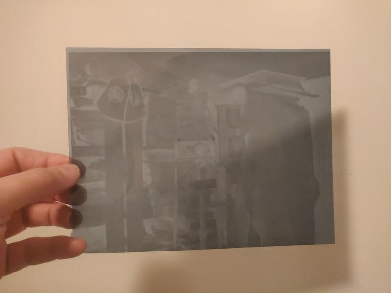

Anyway decided to try this. Shaked the small bottle well so to homogenize it. Used 2% solution with a sheet of old Agfa Mamoray (single-coated x-ray). Made 300ml, ie. 6ml seringed of this cream.
This is the developed sheet:

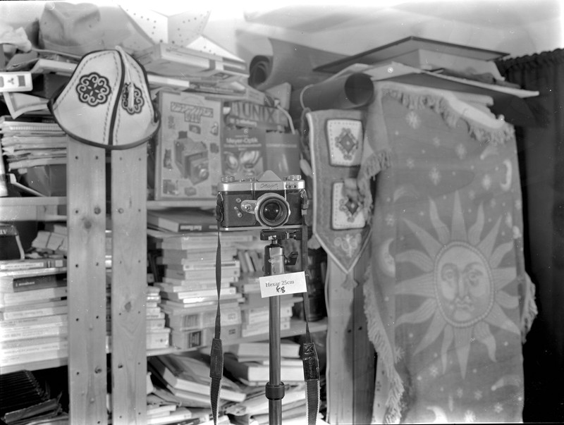

not printing to paper, went digital in order to have an idea. V700 scan at 2400 dpi and ColorPerfect inversion
800x JPG:
detail:
so this creamy stuff seams useable. Yet I prefer to obtain a soluted concentrate instead. Was expecting dissolution to be easier than in the case of borax.

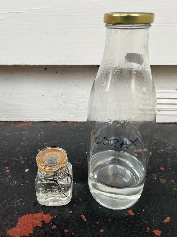

@srardnec welcome to Photrio! Your example negative looks rather thin (underdeveloped) to me.
If all your chemicals are OK, it should dissolve if it is heated enough as others in that thread also found. But by Albada's rule for stability it is correctly predicted to crystallize eventually:

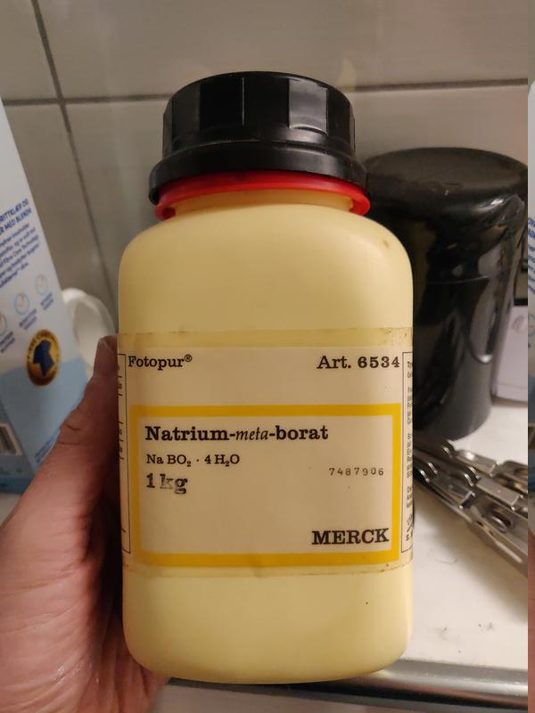

I'll throw another something out there to chew on when it comes to sodium metaborate. I recently mixed a batch of PMK pyro and had a devil of a time trying to get the sodium metaborate in solution B to go into solution. I'm now wondering if my "older than the hills" Kodak Kodalk is the problem being 8-mol and being exposed to the atmosphere too long. I did buy some new Sodium Metaborate, but haven't tried to make a new part B for PMK with it yet. The Darkroom Cookbook doesn't seem to say it makes much difference whether the sodium metaborate is 4-mol or 8-mol when making fixers or whatever.
Please check the quality of your metaborate.
just regular sodium metaborate from Merck. Kept dry, etc. I use it trouble free mostly for DK-25R replenisher for D-23 (20g/liter) and in a Diafine ersatz (15g/liter).
How is the condition of sodium metaborate chimically tested?

yes I am aware of the aerial decomposition of sodium metaborate into carbonate and borax. It is in the classic ilterature. It doesn't impact solubility. I was wondering about any saturation threshold with ascorbic acid or about an interaction sodium metaborate with ascorbic acid if any.

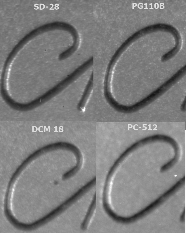

I grabbed a Tessar lens, the Industar-37 300mm @f4,5 and some sheets of 2019 expired Agfa Mamoray cut to whole-plate, and took four shots.
this is x-ray film. I develop in tray with light constant agitation.
The reference developer was SD-28. ie. the Konica buffered D-76 with a bit of potassium bromide. 1/3 dilution of SD-28, for 5mn 15s.
Using this reference time, I developed one sheet in PG110B, one sheet in the creamy emulsion I got of DCM18.
2% dilutions ie. 6ml for 300ml water.
for the PC-512 borax, I used 6ml of the yellow concentrate, in 300ml of the borax solution, ie. 6,51 of borax in 300ml (21,7g for a liter).
It works much stronger/faster than the others, and reached a similar thickness quicky, so I took it into the stop bath after 2mn 15s.
there is more or less drags on some sheets, caused by insufficient soaking/washing of the halation. I developed quickly so didn't bother with soaking bath, just under the faucet
to get a quick idea, V700 scan @2400dpi and ColorPerfect inversion as grade 2 virtual printing. Resize the raw files to 800x600 as 90% jpg for display here.
the initial "reference" one in SD-28 (1/3 dilution, not 2% like wrongly written in the label):
PG110B:
DCM18:
PC-512:
a crop on the S of the camera name. 100% zoom in the raw file, saved lossless as PNG:
Great comparison, but you sure got a lot of streaking.
streaking yes a lot. As said I didn't care much about a good pre-soak/wash of the anti-halation, instead of a bath I washed quickly under the faucet both sides. Where there is most streaking is where I washed the quickest. Actually no pre-soak may have been better but for the sake of this quick comparison it doesn't matter.
What leaves me a bit perplexed is the time with PC-512. Because the mix of ascorbic acid into glycol turned yellow, I was supposing reduced activity due to oxydation, but in fact the sheet reached correct density under the red light after 2mn instead of 5mn with PG110B, DCM18 in same proportion 6ml concentrate for 300ml. The maths seems correct for mixing as per relistan instructions: 1:50 ie. 2% of concentrate, ie. 6ml for 300ml of a borax solution 21,7g borax/1liter. I didn't mix a liter but 6,51g borax in 300ml water, ratio kept.
ideally now I should use these times as starting point for further tries. I don't mind wasting lot of sheets of x-ray film, but with regular film I will use 4x5 sheets or cut 120 roll for 2x3 grafmatic holders.
Given how much trouble you had dissolving/mix the concentrate, and the wildly differing time, I'd suggest you perhaps measured something wrong when mixing it. Which may also have had an effect on the result you got. Are these crops all the same density? Additionally... it does not normally start off yellow if you mixed it correctly.
