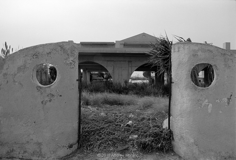

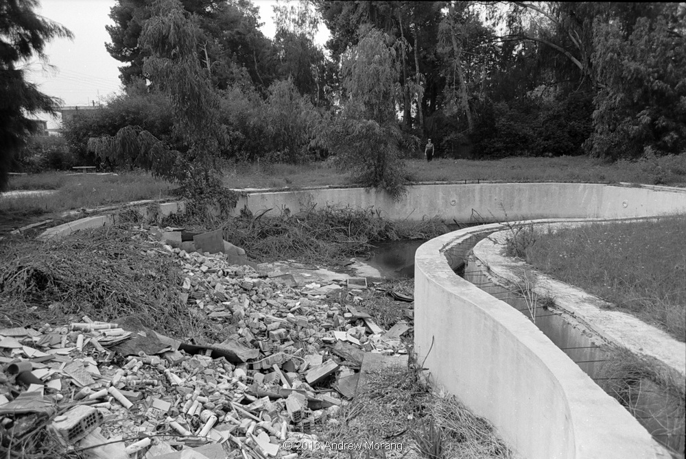

Here are some examples from Romania and from Greece. The view of a church is in Sibiu, Romania, with a yellow filter to darken the sky. The abandoned hotel is in Nerantza, Greece. The film was Fujifilm Acros, exposed at EI=80. Praus Productions in Rochester, NY, developed the film in Xtol. I scanned the film with a Plustek scanner using the Tri-X 400 profile (the SilverFast software does not have an Acros profile).

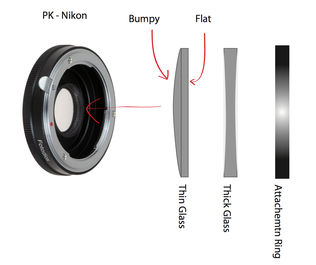

Thanks for your reply. I was curious that M42 could mount to Leica M and still focus at infinity, so I looked up the site. I could still not find your adapter on the site, but I found the Rollei SL to Nikon adapter I had always been looking for. In that case the only way to have infinity focus is with an extra optic element. It is less then $40, so not much risk in trying it. I'd like to try my Zeiss 35mm 1.4 on my Nikon F100. I also see they have reasonably priced replacement alligator-connector Rolleiflex TLR camera straps. I found a New one about 15 years ago for about $150.

If there is an lens in the adapter it will be a weak single negative element, or perhaps a cemented achromat (not likely). This will increase the focal length of the Rollei mount lens a small factor, perhaps 1.2X, which would give a final focal length of 42mm for the lens/adapter combo.
Fotodiox website shows this image for another adapter, maybe the Rollei to Nikon adapter is similar. The FAQ also indicates the factor is 1.4x for the flange focal length but it does not mention field of view or effective aperture changing though Fotodiox responded to a question here indicating a reduction if field of view with the adapter:
A plus is that is seems to be three glass elements that can come out, making the adapter an extension tube for close up photography.
I may get the adapter and report back.
If the Rollei to Nikon adapter has a 1.4X factor then your 35mm f1.4 will become a 49mm f2 lens, probably with really bad edges and corners until you stop down to f8 or even f11.
Since it is so inexpensive I may get it just to see what it does. I do still have six working Rollei bodies for my Rollei QBM lenses.
