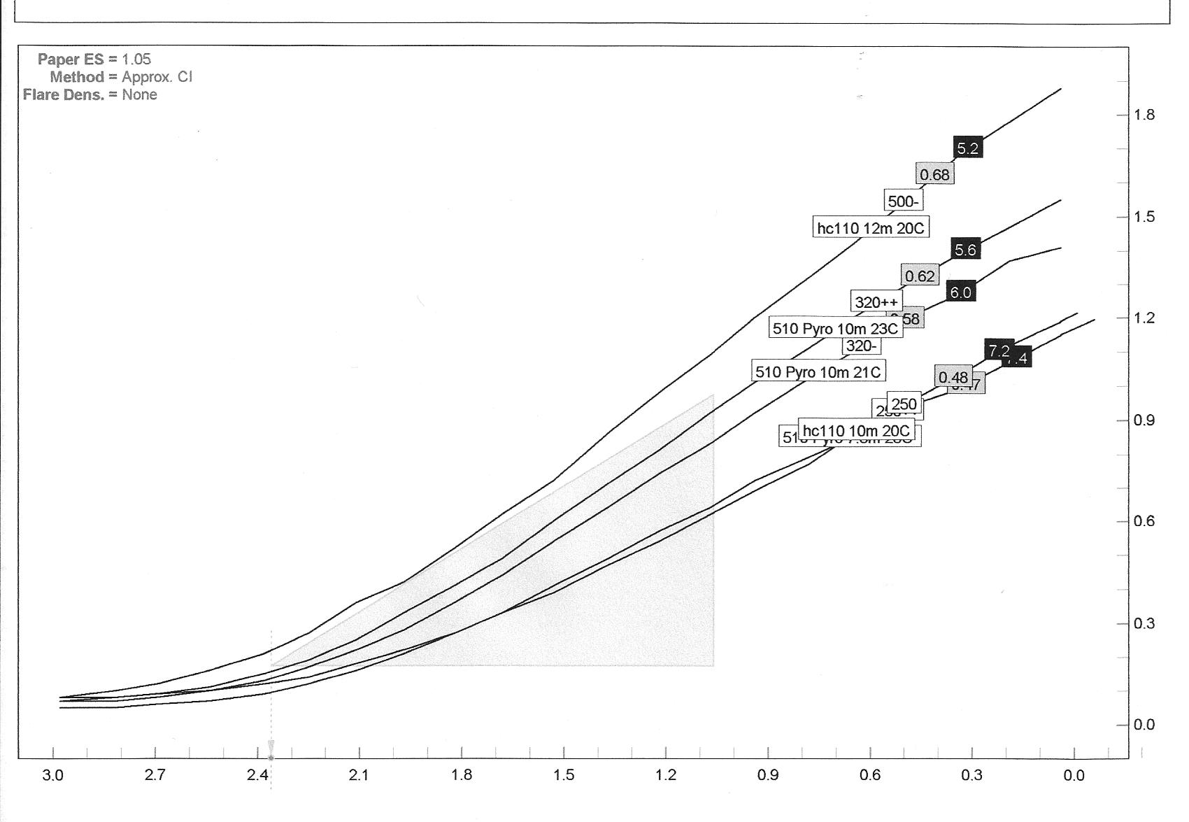

510 Pyro.jpgHere are results of my 510 Pyro with HP5+ tests with the following updates: 99% TEA from chemistry store instead of 85% from PF, Pyro from PF instead of my homemade Pyro, distilled water instead of tap, kept TEA below 65C when mixing the chemicals, ran the jobo at low 25rpm. This time the stock is clear or slightly yellow instead of fairly dark red. The spent developer is quite oxidized but not totally. The improved developer is more active but the development times are still not close to the massive dev. chart or other reports. However, it seems quite useable. I'm using the 1:30 min water rinse for a stop, and neutral rapid fixer 4min.
Comparing the 510 Pyro at 1:100 with HC110 at 1:63, the HC110 I use at 11 or 12 min 20C for good film speed and gradient similar to another post I saw recently. 510 Pyro at 7.5min 23C G=.47 is close to HC110 at 10 min 20C G=.48. The 510 Pyro at 10min 20-23C G=.58-.62 is pretty close to what I would use, comparable to HC110 11min 20C.
The fog levels are nice and low.
Where are all the results and what did you see?
Also, remember that staining developers have images in the UV which you cannot see.
Tell me (us) more!

I guess the contrast could be different for the pyro on vc papers. My wife is also saying "when do I get to see a photo?" so I should actually try do a print one of these days.
I'm using enlarger light with the Darkroom Automation meter for a densitometer. It works quite well. I notice a few percent or so increase in contrast measurements if I use cyan light. I think the UV would give around 10% higher contrast.
