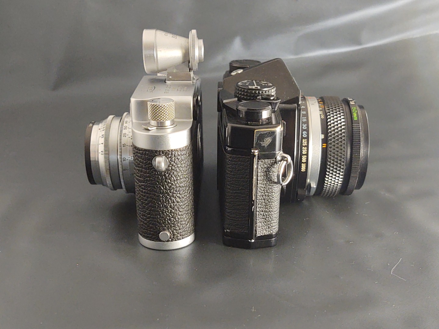

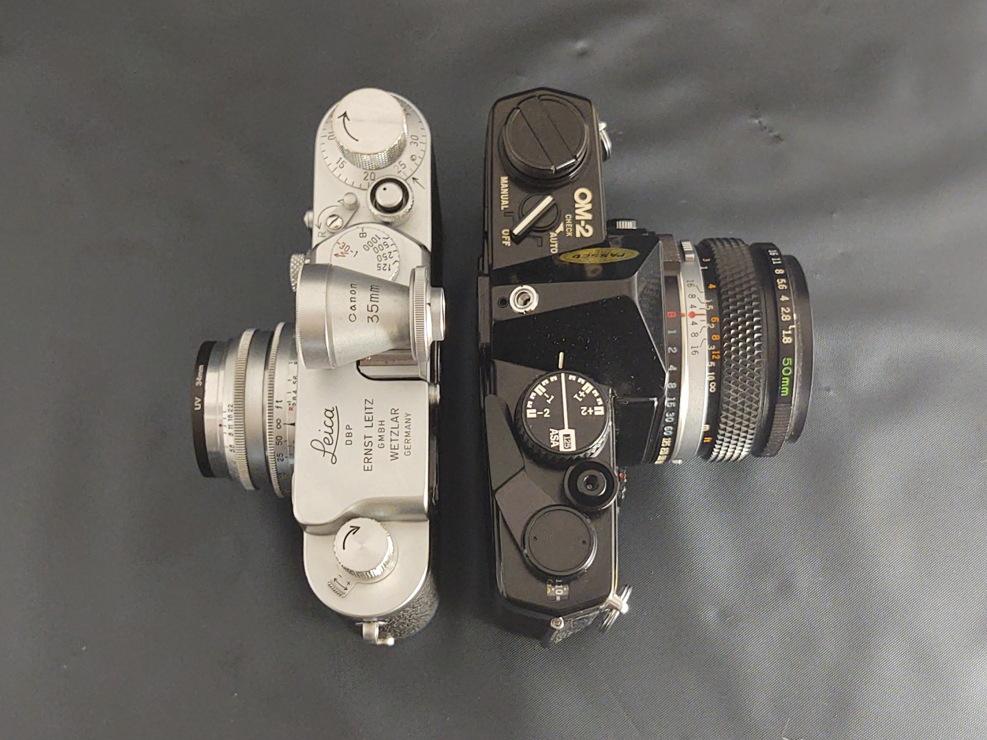

A small slr like an Olympus or Pentax or Nikon fg is 1000x easier to use and about the same size.
When I got my OM1 in 1979 it was because I felt it was the closest I could get to a Leica in size and low noise that I could afford. Recently I got a Nicca copy of the IIIf, had it overhauled by Youxin but couldn’t get on with it. As stated above it is fiddly and just more difficult to use than the OM. The fact that I am an eyeglass wearer didn’t help. Then I got the Leica I have wanted for decades, an M2- entirely different story, a pleasure for me to use. As much as I find the old LTMs attractive I don’t really want to use them.
