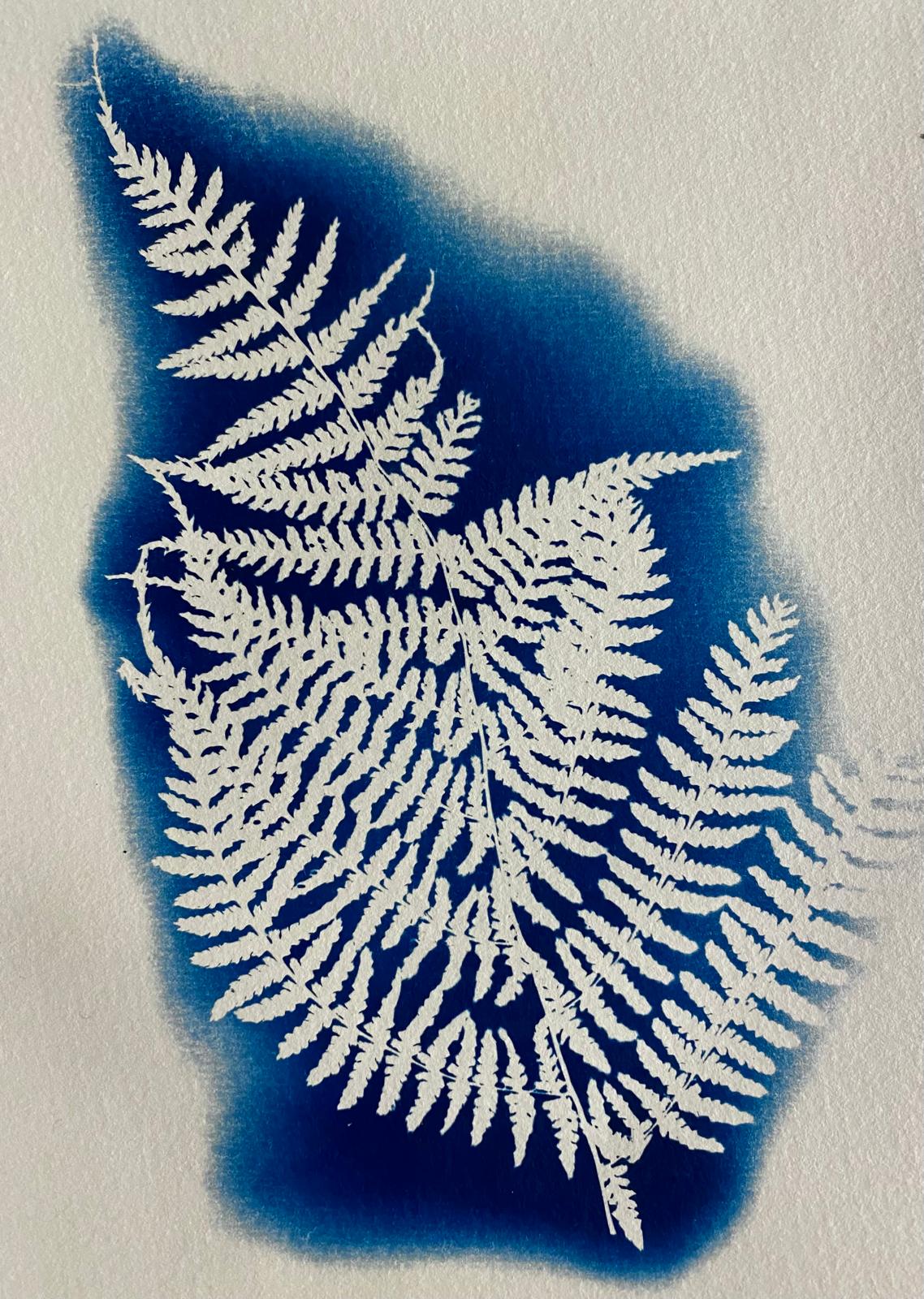

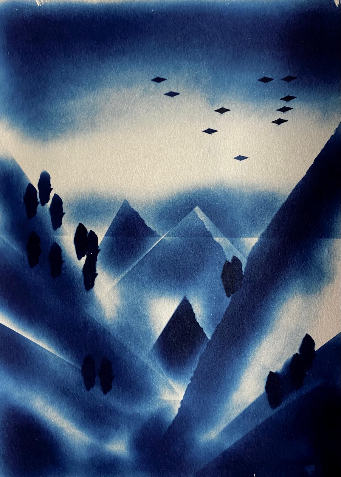

The left image was made using a dried fern leaf and tracing over it to get the silhouette only. The right image, I would call it a mountain view illusion was created by just using 2 pieces of paper as mask and one of them had 2 small holes in it to create the "birds" and "trees".
It is a way of working very quick, for example the right image was created in 2 minutes and including rinsing 30 minutes later the print was drying.

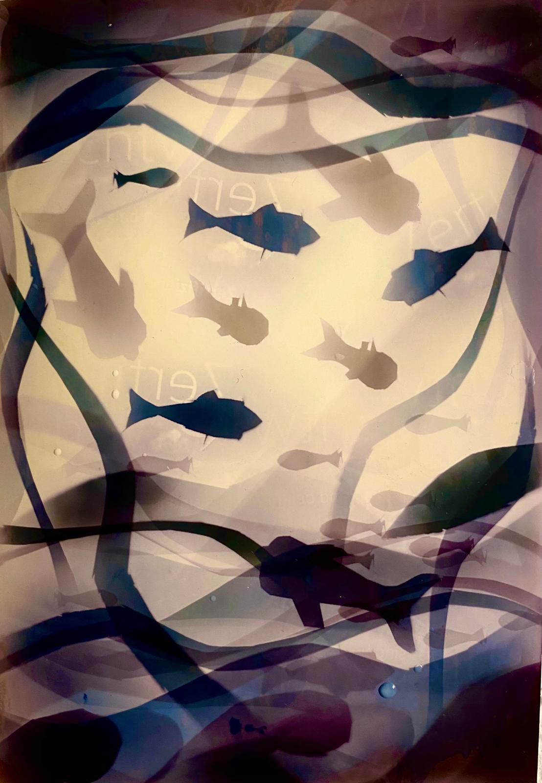

Here 2 more from today.

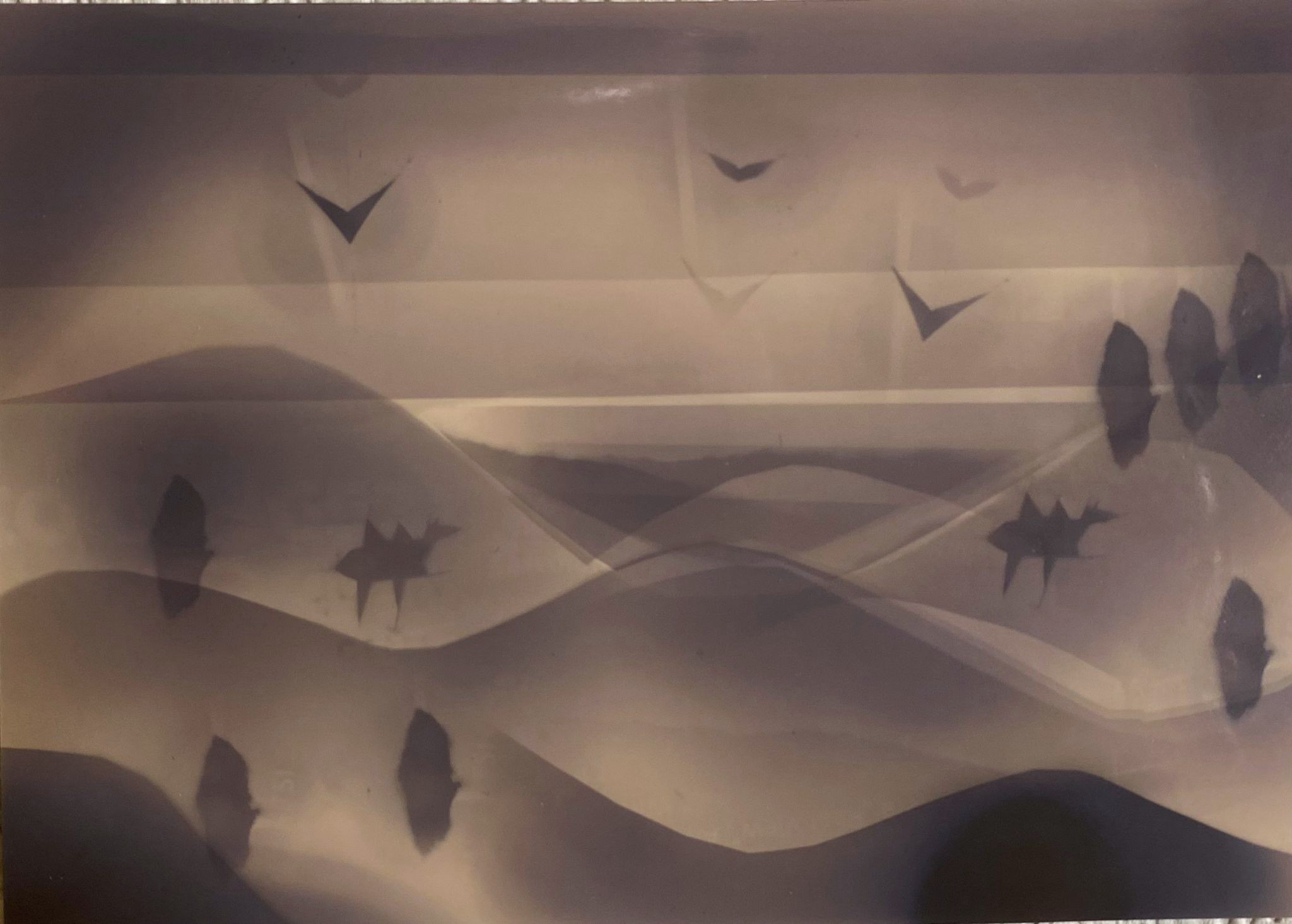

After your suggestion here a Lumen, same method. On Agfa multi-grade. 10x15cm
- It us much more sensitive so almost to fast to work with the UV-flashlight. I would have to cover it a bit.
I show you the original, undeveloped after my Segmented layered exposure. In silver this is to crude, but a good experiment.
right is after very diluted development in old developer and then fixing. It stays pink-red.
-contrast is not so striking as with cyanotype
-my UV is to aggressive and not fine pointed for this, have to blend it.
-more practice needed for better results
- pictures are a bit on the dark side, in real it is slightly brighter.
- total exposure about 1 minute.

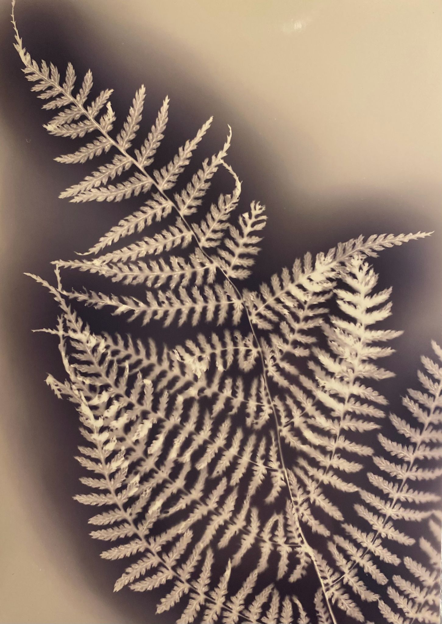

Yes it works fast so after the previous, I put a dried Fern leaf under glass and manually traced it. Here you can see I get more contrast. Here just after exposure. These then would have to be kept out of the light. Advantage it is much faster indeed this was again about 1 minute total.

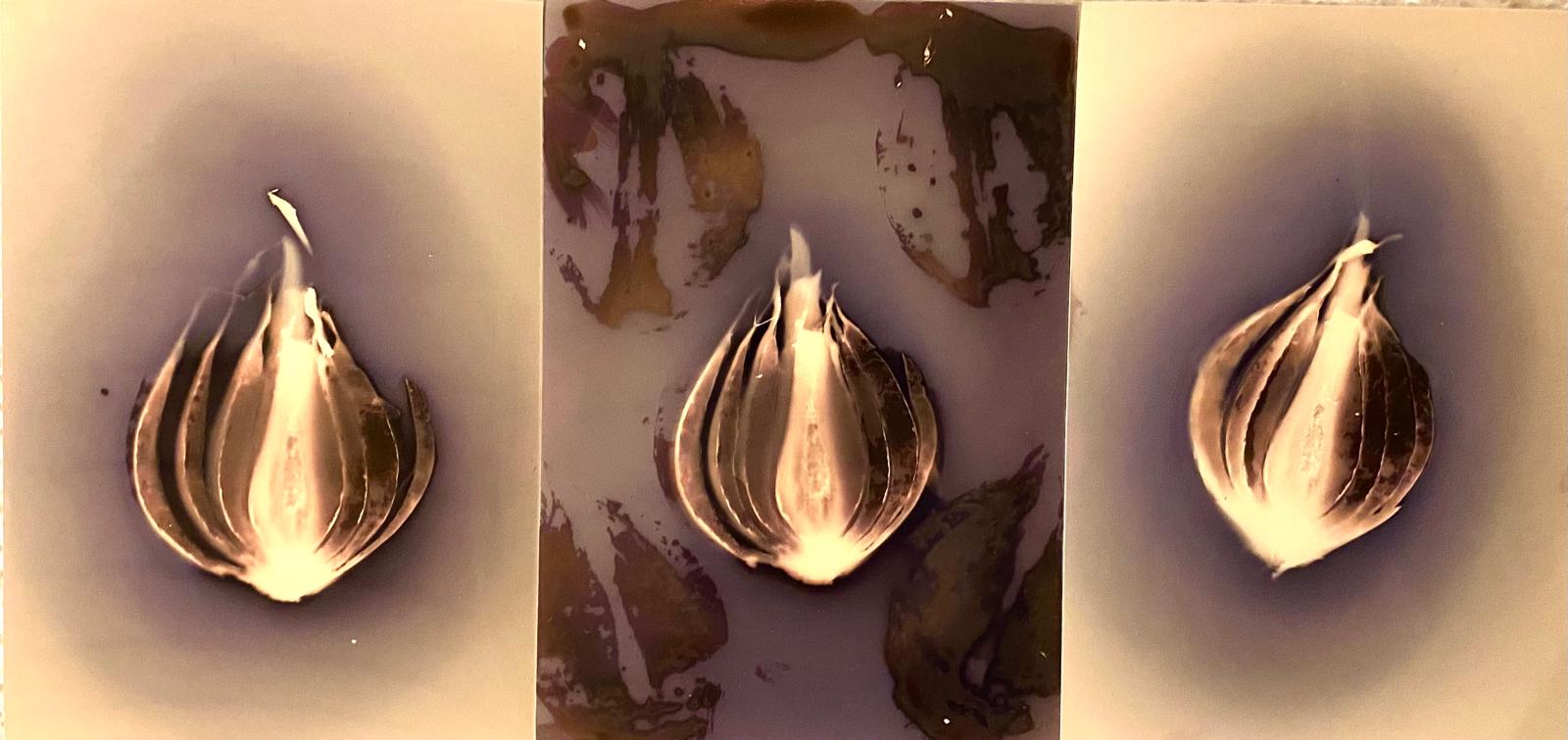

Some further evolution in the experimentation, I have now picked up Onionography. The fast action of the concentrated UV light from these flashlights allows to do experiments much faster and so iterate faster to new things. Using the same Agfa Multigrade photo paper and an onion I discover the Onion juice also has a nice effect dry photo paper. Just sharing for inspiration and further experimentation. Still Lumen only so not developed. I guess the sulfur in the Onion reacts with the silver under UV light
Format 10x15 cm Onion Slice about 5 mm thick exposure by tracing and staying a bit longer on the thicker parts, total time about 3 minutes.
What happens is onion juice being rich in sulphur compounds, nucleates the silver halides in the photographic paper, post which the paper prints-out more effectively under UV light.
When I was working on nucleation of photographic film in reversal processing, I did some experiments with nucleating photographic paper too. I gave a short rinse to the paper in weakly acidic Thiourea solution to nucleate the halides in the paper. After a short wash and drying, I made a Lumen contact print on the nucleated paper. Two effects could be noticed - 1) exposure time decreased significantly 2) printout was more reddish brown and the colour was mostly retained by the print after fixing.
The same idea works when Cysteine Hydrochloride is used in place of Thiourea but the result is dark brown. Cysteine Hydrochloride is less toxic than Thiourea. Weakly acidic Kala Namak should also function similarly, haven't tried that. Maybe onion juice and Kala Namak might like each other in printmaking just as they go well together in cooking. 😄
