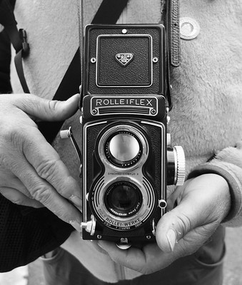

Hello everyone,
I would appreciate some first-hand experience regarding Paepke Fototechnik in Düsseldorf, particularly for Rolleiflex shutter work.
My Rolleiflex 3.5F (Synchro-Compur shutter) has recently been serviced by a very experienced Rolleiflex technician in The Netherlands. The camera received a CLA, mechanical inspection and a repair of shutter speeds that were way off.
The slower speeds seem to be stable now, but the shutter speeds are still not within specification.
Measured before service (using a shutter tester), the results are:
  • 1s → ~1/0.8
  • 1/2 → 1/3.2
  • 1/4 → 1/5.78
  • 1/8 → 1/9.79
  • 1/15 → 1/26.42
  • 1/30 → 1/42.89
  • 1/60 → 1/130
  • 1/125 → 1/277
  • 1/250 → 1/280
  • 1/500 → 1/425
The 1/60 and 1/125 speeds are more than one stop fast, while 1/500 does not fully reach nominal speed. The technician indicated that he was unable to bring the shutter fully back into tolerance, possibly due to internal wear.
After the service:
  • 1s → ~1/0.8
  • 1/2 → ~1/3.2
  • 1/4 → ~1/5
  • 1/8 → ~1/7
  • 1/15 → ~1/10
  • 1/30 → ~1/40
  • 1/60 → ~1/100
  • 1/125 → ~1/250
  • 1/250 → ~1/300
  • 1/500 → ~1/400
Now, I've sent the camera to Paepke in Düsseldorf.
I would appreciate hearing from anyone who has had a Rolleiflex serviced by Paepke, had significant shutter timing deviations corrected successfully, can comment on their current pricing range for shutter overhaul or deeper mechanical work.
I don't think that a complete shutter restoration is needed. I’m simply trying to determine whether this is likely to be a minor adjustment, a full shutter rebuild, or potentially uneconomical.
Many thanks in advance for any insights.
