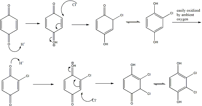

That "synthesis" is problematic at best. They use Quinone + HCl which does give Cl-HQ, but then it goes on to oxidize with even the smallest amount of O2 present to give Di-Cl-HQ. It is reported to be 4x more active than HQ alone. (See attached)
With Sulfite present, it would probably give the Cl-HQ-Sulfonate.
The best actual synthesis is in anhydrous benzene with gaseous HCl at about 80C and 4 atm pressure. Very ungood.
This is why I doubt that Edwal got what they expected in their developer which was Q + HCl + Sodium Sulfite + NaOH in an undisclosed sequence.
PE
PE
Thanks, I wondered about the actual reaction because it never seemed to work out right on paper. However, at the time I didn't care enough to follow it further. I did synthesize another developing agent mentioned in Glafkedes pyridyl hydroquinone by refluxing quinone with pyridine.
