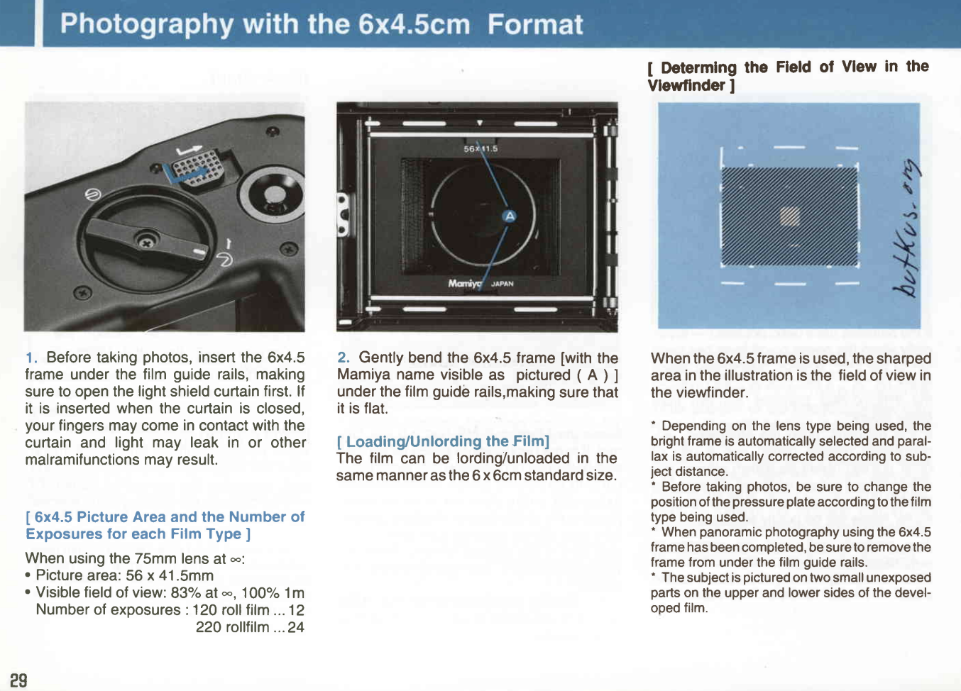

Imagine the Mamiya 6 with an option to shoot 645 AND GET 16 SHOTS (before someone says the 6MF!).
This would be my dream camera.
I own the 645 mask for my 6MF. I have never tried it. I'm guessing it will not snap into place in the plain 6?
I guess I need to make a distinction between the GS645 (the folder) and GS645S (non folder). As a travel camera for an upcoming trip the UK, the wider angle of the 60mm lens on the S is appealing vs the 75mm of the folder.
There's a gs645s for sale on Seattle criagslist.
Dreams...... The Mamiya 6 still gives you 12 shots with the top & bottom cut off the 6x6 AFAIK
