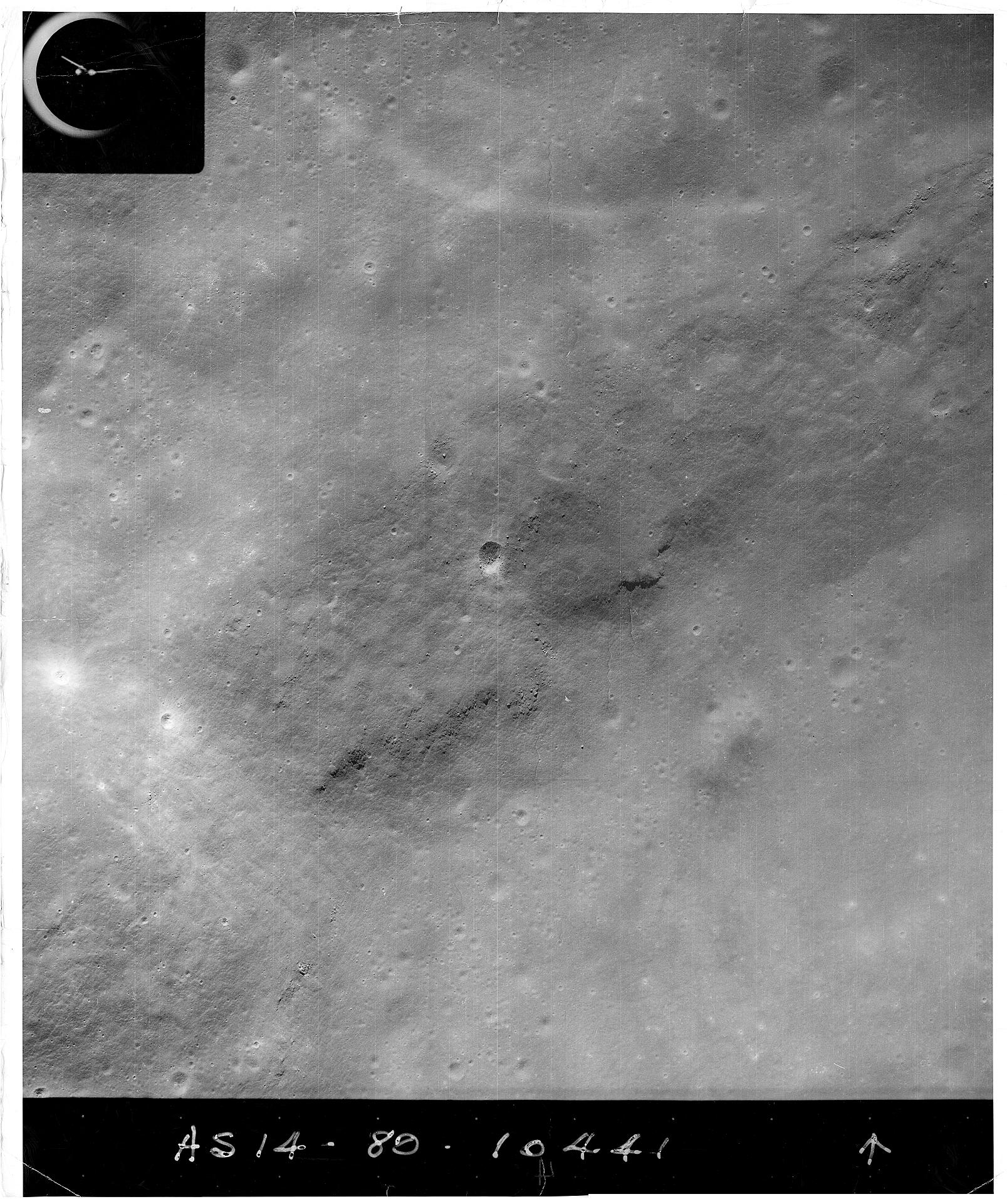

Because I have acquired 10 20"x24"inch prints of magazine AS14-80 and together with Paul, am working on scanning and processing them.
We will present an other source for the images, and in much greater resolution and fidelity than previously online. Most of our scans were previously only available as ultra-low resolution scans from the Apollo 14 photo catalog.
We will be providing the highest-resolution scans of these photos online to date.
I use my Epson Perfection V750 Pro to scan the gargantuan print in 6 sections, making sure there is ample overlap between the scans. Vuescan 9 outputs two files, a contrast/brightness enhanced scan, and the uncorrected RAW scan. Both files are saved as 16-bit grayscale uncompressed TIFFs. Sharp prints are scanned at 800 DPI, soft prints are scanned at 300 DPI.
Paul then uses photoshop to merge the 6 individual scans back into a single image. The combined scan is saved in two versions; the uncorrected RAW version, and a contrast enhanced, sharpened version to try and get the most detail out of the prints possible. Due to the nature of this process, there may be some visible stitching where two scans meet.
The resultant image resolution is 307 Megapixels.
A photo of one of the prints:
A Full-HD preview of the links below:
Full-res 307-Megapixel download of raw merge
Full-res 307-Megapixel download of the contrast enhanced/sharpened merge
Once all the prints have been scanned and processed all the individual scans and merges will be provided, in RAW and enhanced.
Please tell me what you think! I and Paul would like feedback.

Scan of AS14-80-10441 compared to LRO
AS14-80-10441 is a high-magnification photo of the Theophilus crater, see here Note the website preview is only half the resolution of a raw scan tile.
The Apollo 16 ITEK Panoramic Mapping Camera compared to the Hycon KA-7A (Keep in mind AS16 is a NASA scan from the original film, and ours is only a scan of a print.)
